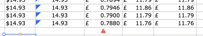

Once a year I convert $ amounts into £ In this NUMBERS spreadsheet. Entries in Col A are copied/pasted from a website. CURRENCYH in Col D doesn’t recognise the pasted value in Col A as a number, I have to use a REGEX formula in Col B to convert the pasted TEXT string into a number.
This year, NUMBERS tells me with the blue triangle in Col B:
This formula produces multiple results in newer versions of Numbers. It has been modified using the “@“ operator to return the intersection of its cell references instead. Original formula: REGEX.EXTRACT(F33,“[\d.,]+”)×1
Indeed the automatically amended formula reads: @REGEX.EXTRACT(F35,“[\d.,]+”)×1
My spreadsheet still works, but I’m a bit lost about what happened here. What is an “intersection of cell references”? How can ONE formula produce multiple results?
I’m not a Numbers user, but when searching your problem, I found this post to Apple discussions.
Basically, in some recent update to Numbers, several functions have been changed so they may accept either a single cell reference or an array-reference (that is, a range of cells), whereas in the past, they only accepted single cells. REGEX.EXTRACT is one such function.
The prepended “@” is an “explicit intersection” operator which forces the function to accept a single-cell-reference (the only way it worked in older versions).
Since your sheet was migrated from an older version where only cell-references were supported, the “@” was prepended in order to make it explicit. The alert icon is to let you know that the formula was modified. You should be able to just dismiss it.
In your situation, it is superfluous, because “F33” is a single cell reference. But if you were using other kinds of references (e.g., “$A”), it would be ambiguous - it could mean “column A on this row” or “all the cells in column A”. The “@” operator tells it you mean the former, not the latter.

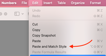

The concept of a ‘paste and match format’ works in Numbers 14.3 in Sequoia.
To get a column of numbers for testing I screenshot a bit of a Wikipedia table, opened the screenshot in Preview and copied the numbers via the Live Text function of Mac OS. Next, I opened a new blank Numbers sheet and pre-formatted several columns and titled accordingly. Finally, I clicked in the top cell of each column and pasted using the “Paste and Match Style” command.
This is the result:
Note that the Option+Shift+Command+v shortcut works in a lot of apps, not just Numbers.
