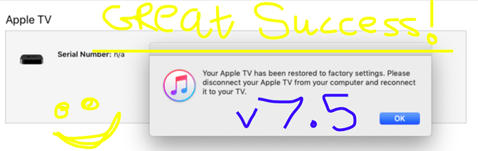

The answer is simpler than you realize. There are two different models of the third-generation Apple TV. AppleTV3,1 is model number A1427 (released March 2012). AppleTV3,2 is model number A1469 (released March 2013). Look on the bottom of your unit or in the Settings->General->About screen to see which model you have.
There are two different links to 12H885, one for each model Apple TV. You need to use the one that matches your hardware:
- AppleTV3,1 (A1427): Download iOS 8.4.3 (12H885) for Apple TV 3 / IPSW Downloads
- AppleTV3,2 (A1469): Download iOS 8.4.3 (12H885) for Apple TV 3 (2013) / IPSW Downloads
My unit is a 3,2 so the download for 3,1 failed to install. But the download for 3,2 worked.

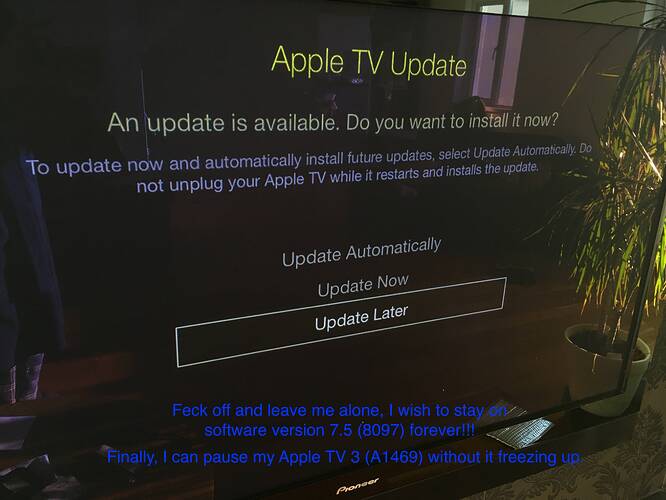

Be sure to immediately turn off automatic updates because it will try to upgrade itself to 7.6.1 soon afterward. With auto-updates disabled, it will still nag you to upgrade (and you have to remember to click “Later”, since there is no “no” option.), but at least you can pause YouTube again.

What confused me more than anything is someone in this thread muddied the waters by claiming Apple were no longer signing 7.5. That threw me off the trail after my first attempt failed.

The coloured text is an optical illusion.
