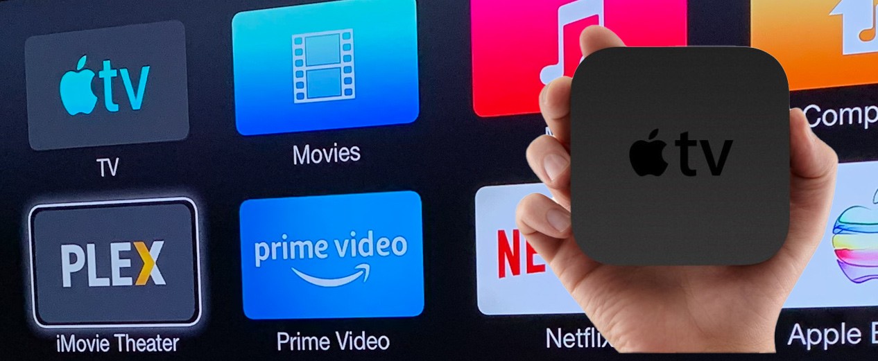

Third-Generation Apple TVs Suffering from Apple TV Software Update 7.6
Originally published at: Third-Generation Apple TVs Suffering from Apple TV Software Update 7.6 - TidBITS
If you’re having problems with your third-generation Apple TV, you’re not alone. Apple TV Software Update 7.6 seems to have some issues. You may be able to downgrade, but regardless, be sure to tell Apple of your woes.
