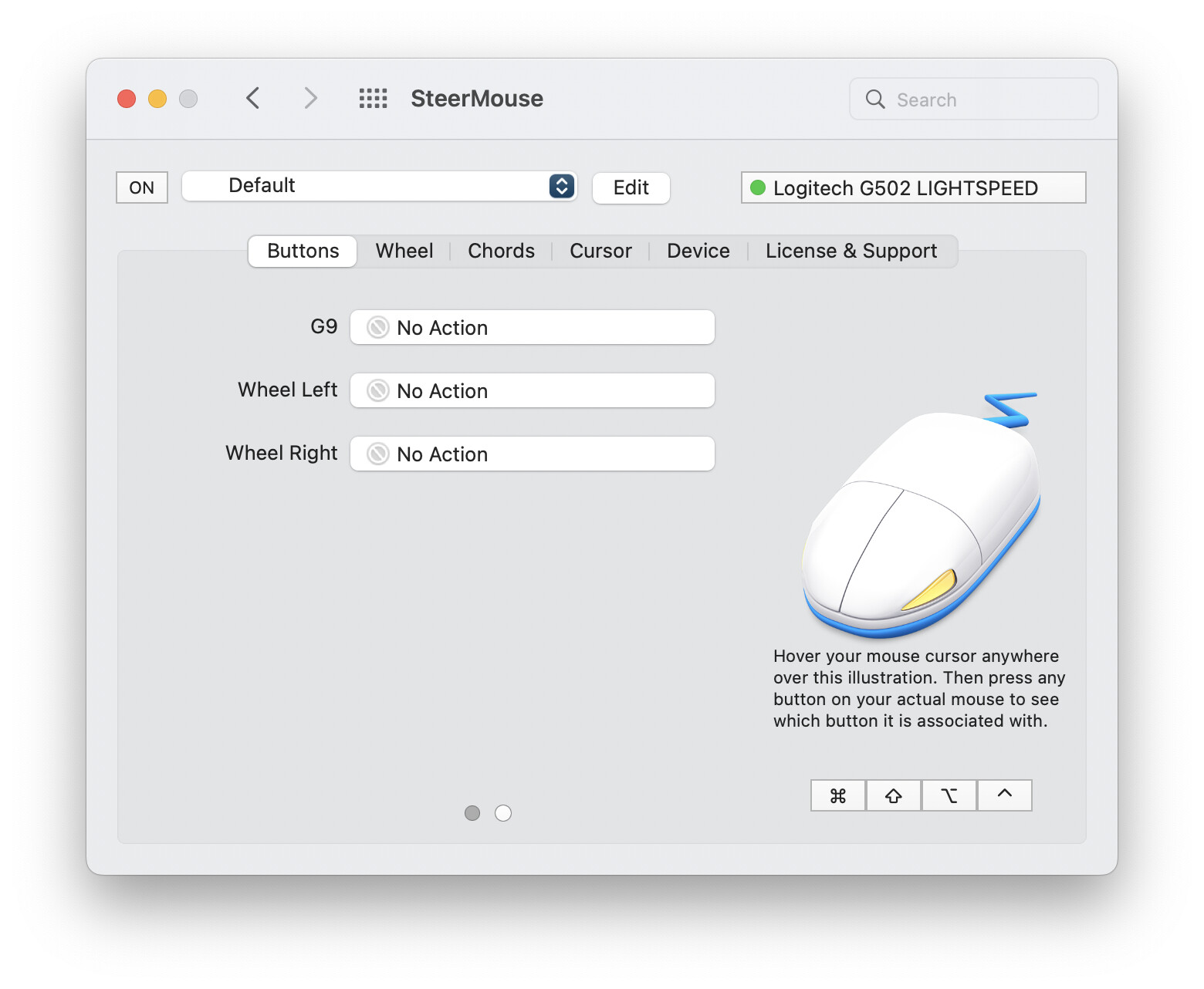

The G502 allows the scroll wheel to be tilted left and right (as Michael mentions above). The response to that can be configured here:

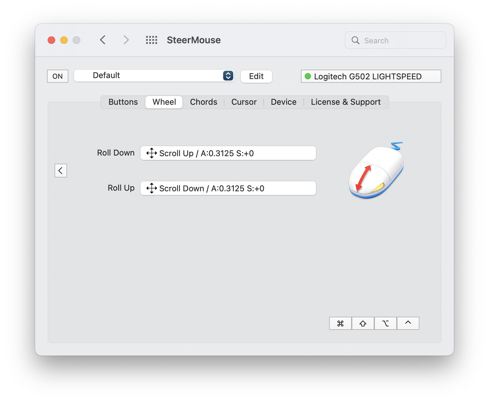

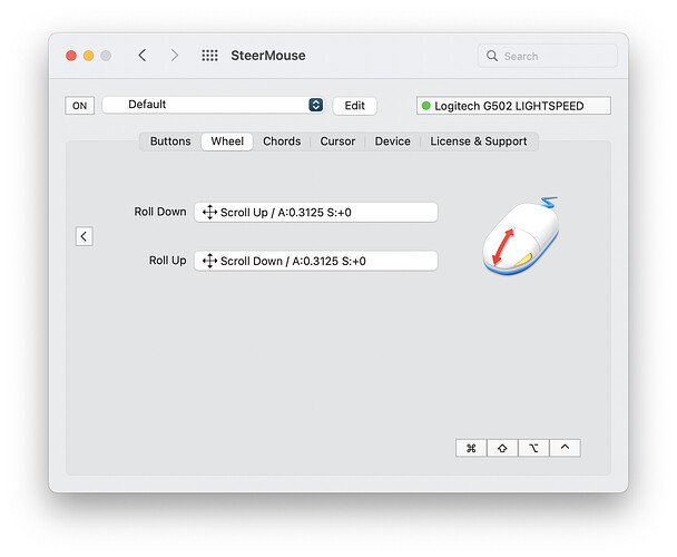

The response to actually rolling the scroll wheel can be configured here:

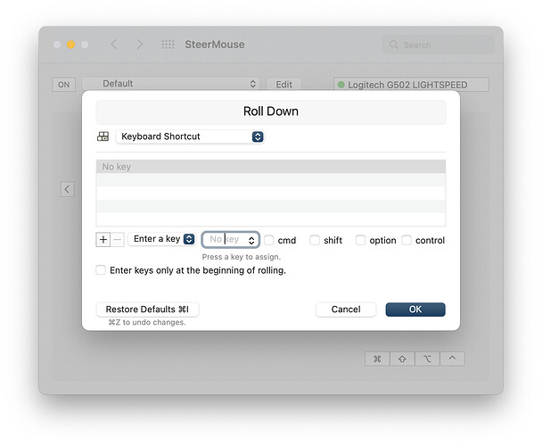

When you click the button to the right of eg “Roll Down”, many possible kinds of response can be configured. Causing a left / right arrow button press would be under “Keyboard Shortcut” here:
I haven’t tested your exact needs, because I don’t want to mess up my son’s configuration. Also I don’t have an MX Master 3S. So I’m not absolutely sure SteerMouse will do what you want. But I’m fairly confident. SteerMouse has a free 30 day trial.
