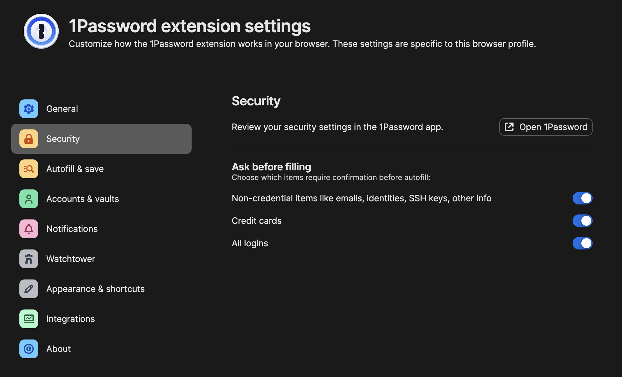

Use a Chromium based browser or Safari. Here is the settings as seen on Arc. The Credit cards setting was on as default. The same settings are in the Safari version.

Sorry to be so dense, but I can’t seem to find these settings in Safari?

The user interface is identical with the screen grab above from Arc.
Make sure the 1Password button has been added to your Safari Toolbar first? You can do this in Safari menubar/View/Customize Toolbar?
Then clicking on the toolbar button brings up Safari’s version of the screen @paal posted when, from the main 1Password screen that lists all your logins, you go to Menu (the three stacked horizontal lines “hamburger” icon) /Settings/Security?

1Password’s solution:
To turn on autofill confirmation prompts:
  1. Open and unlock 1Password in your browser.
  2. Select the menu button and choose Settings, then select Security.
  3. Select the items you want confirmation prompts for in the Ask before filling section.
After you’ve turned on autofill confirmation prompts, you’ll be asked before filling on every website. Malicious or compromised websites cannot hide these prompts. …
Thanks for the tips @Halfsmoke – now I see the settings.

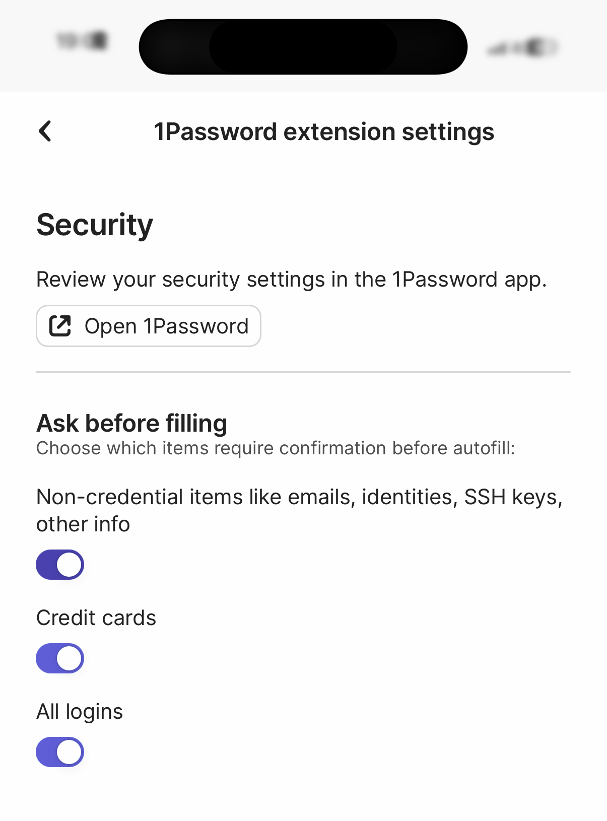

This discussion has as of now focussed on 1Password and Safari on the Mac. Thanks for the advice given.
But how about 1Password and Safari on the iPhone?

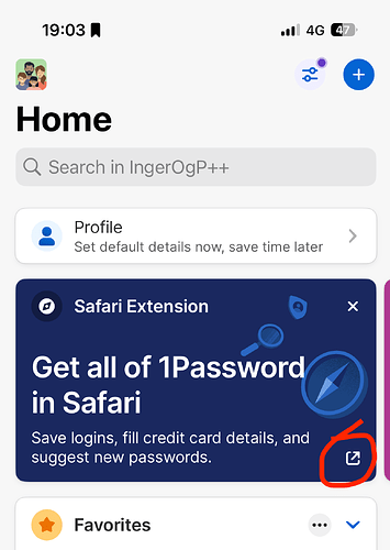

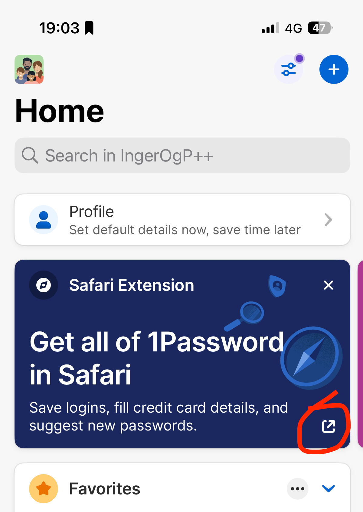

There is a new version 8.11.7 that has the same options as on the Mac when used in Safari. Download the app and click to install as indicated by red circle.

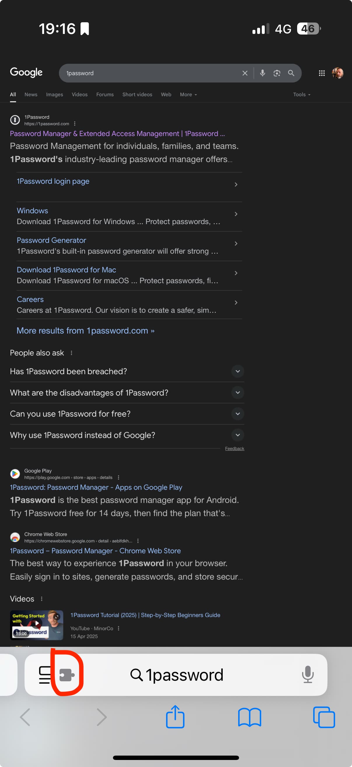

After it has installed click puzzle piece
Select 1Password.
Click hamburger menu and go to Settings. You will find this under Security.

  1. Click the 1Password browser extension icon in the Safari toolbar
  2. Click the “hamburger” menu icon to the right of the extension popup window’s search bar
  3. Click “Settings”
  4. Click “Security”
