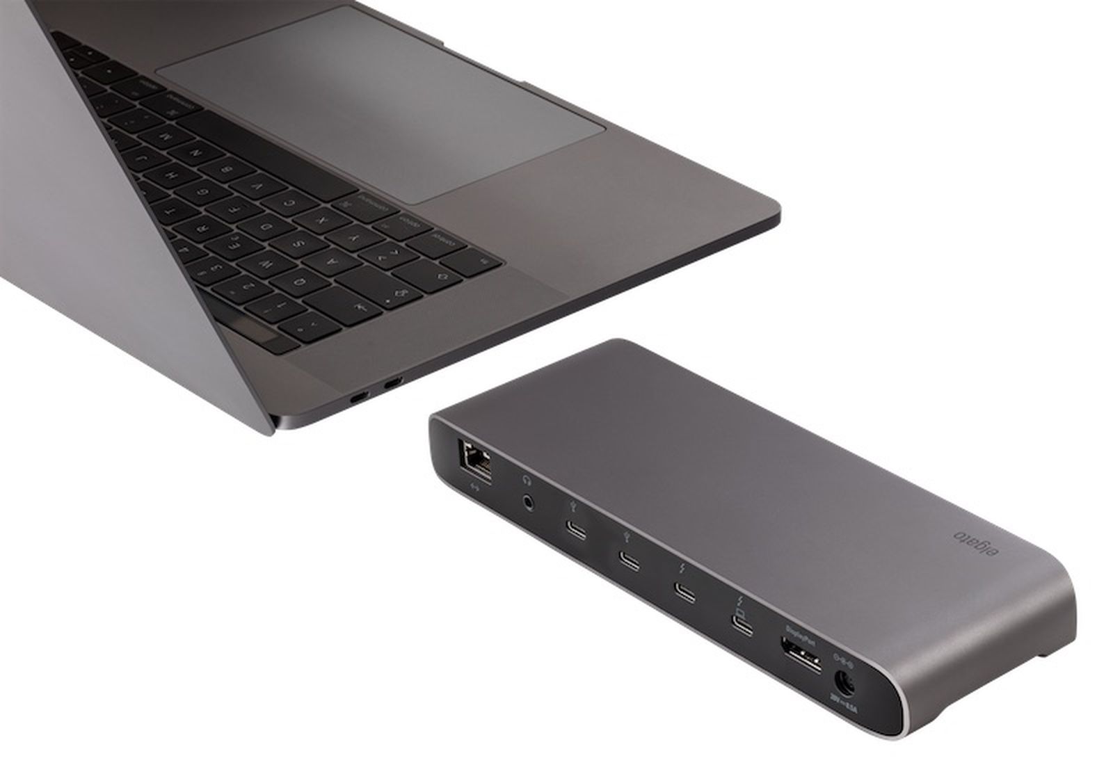

Sadly, it’s May 2020 and the Elgato hub is still the only real option for multiple USB Type C Thunderbolt ports.
It would be really nice to just have a hub with 4 or 5 USB-C Thunderbolt ports and nothing else—that doesn’t cost nearly $300. I don’t need ethernet, display, audio ports, SD cards or anything else… just more thunderbolt ports.
