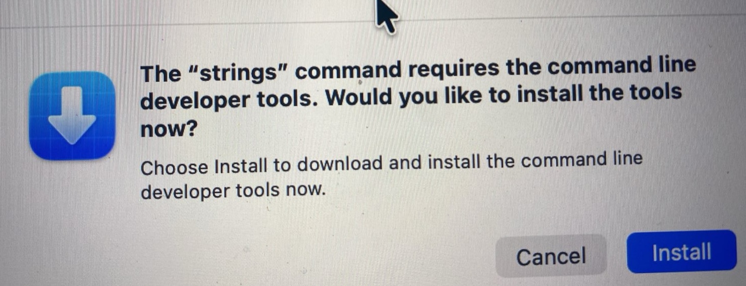

Strings Command, Install or Cancel, what to do?
Updated a family MBPro from Monterey to 26.3. Long story but mostly ok now, main problem is a nagging window that comes up:
every few minutes. I’m not a developer and occasionally use Terminal for small things on my Mac but close to never on the MBP in question.
We have limited internet usage here and have already had to top up many times for the update so am hesitant to click Install for something I don’t even understand.
So I’m wondering
a) if this is safe to do-there’s no indication if this is MacOS asking or who is putting up this dialog
b) if so, any idea the size of download? (ie dozens of MB or several GB)
c) I don’t want to overload anyone with a writing task, but a one/two sentence explanation for dummies about what this dialog text means would suffice ;-)

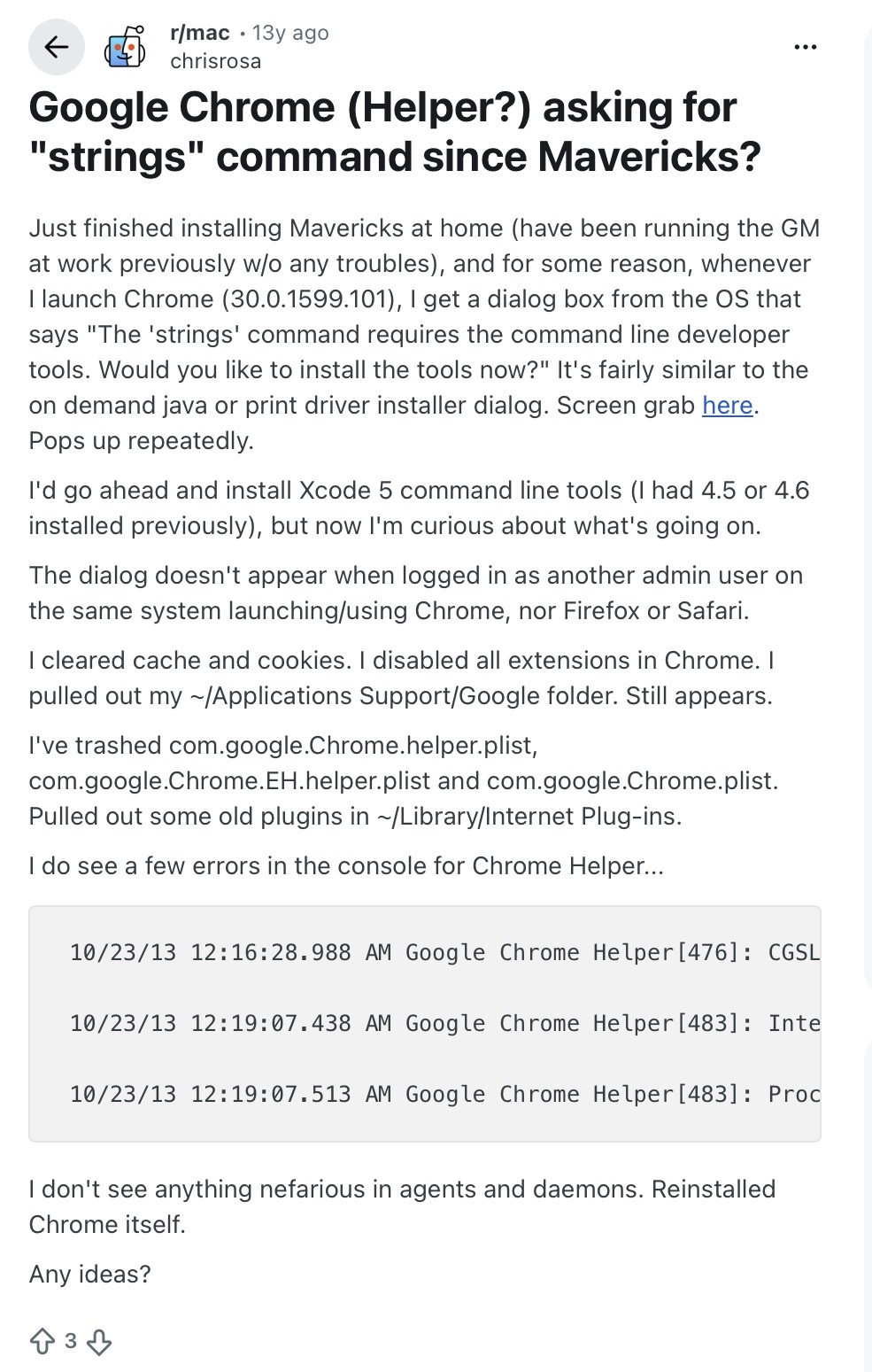

Are you using Google Chrome browser? If so that might be causing the pop-up:
https://www.reddit.com/r/mac/comments/1p1bye/google_chrome_helper_asking_for_strings_command/
Note this is a very old tip

Thanks @mpainesyd yes the MBP in question has Chrome running with dozens of tabs open all the time. Best for use case says the user.
I was blocked from accessing by Reddit at the link but will search elsewhere with chrome related keywords. Sometimes the right keywords are the key to finding the solution; the technique of searching for the exact text of the dialog didn’t work very well this time.

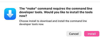

One easy way to check if they are installed is to just run one those commands. One possibility is the make command. Run it from a command line:
$ make -v
GNU Make 3.81
Copyright (C) 2006  Free Software Foundation, Inc.
This is free software; see the source for copying conditions.
There is NO warranty; not even for MERCHANTABILITY or FITNESS FOR A
PARTICULAR PURPOSE.
This program built for i386-apple-darwin11.3.0
If the command-line tools are not installed, you should see a popup asking you to install them.

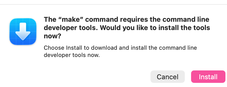

Sorry, was not 100% clear. The dialog in question was on a family member MBP, I still need to wait for that machine to be available to run the commands. I searched for the Xcode on my MBAir and didn’t find it. Kind of mixed things up, duh!
Anyway, ran make and looked in the InstallHistory.plist for “Xcode” and “Command” and neither was found, so it looks like no developer tools on my MBAir. Ran pkgutil from @josehill s post and this dialog popped up behind Terminal:
so that makes it appear that the blue icon and verbiage comes from the OS.
Will search some more on Strings and Chrome to see if there is an explanation there. Added 10GB to the account here at home so might be able to download the tools tonight or if not, remotely when family reaches base abroad, where the internet plan is fast and unlimited.
I’d be surprised if running pkgutil by itself triggered that particular pop-up. It probably came from when you tried to run make.
pkgutil is a standard part of macOS and shouldn’t need anything else to run.

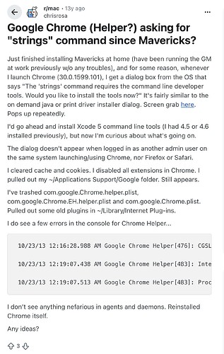

Here is a screenshot of the Reddit post. If the issue is caused by Chrome then you would expect many users would be encountering it but that doesn’t seem to be the case. So it might be that certain Command Line Tools have somehow been corrupted/deleted. In that case the advice of others (above) may work.
Maybe look for Chrome Helper in Activity Monitor and close it to see if the dialogue goes away?
