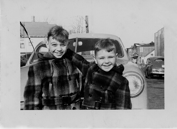

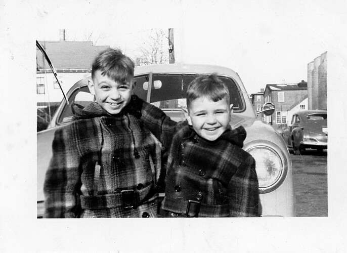

I realize this is a “slide” thread but I hope you’ll indulge these B&W prints as an example of what the software can do.
I took a pic of the pix with my iPhone. The heads in the lower pic look better in the pic than in real life
This is the result in Epson Scan, Home setting, greyscale
This is the result using Professional mode, 16 bit greyscale. This mode doesn’t seem to separate multiple photos on the scanner so I just did one
