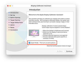

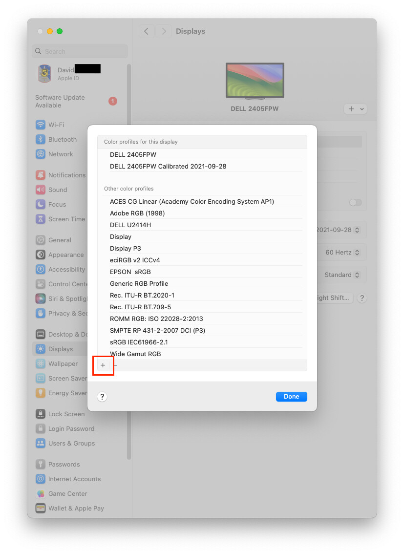

    To do this, go to System Settings → Displays. For each display:
    • Click on a display to select it
    • Click on the “Color profile” item and select “Customize” from the menu.
    • Select a color profile to use as a starting point. I recommend one in the “for this display” set, but any one whose description comes close to your display’s configuration (e.g. sRGB or P3) should also be fine.

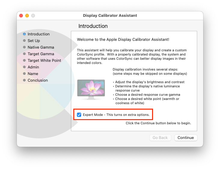

    • Option-click the “+” button at the bottom of the list of color profiles to start the Display Calibrator Assistant tool:
    • Be sure to check the box for expert mode, since that will give you more control over the calibration. If you don’t see that box, then you weren’t holding Option when you clicked the “+” button - close the Calibrator Assistant and try again.
    • Follow the instructions in the Display Calibrator Assistant. When you’re done, it will have created a new calibration profile. Save it. The default name will be (or was the last time I did this) the name of your starting-point profile, followed by the date you ran the calibration. But feel free to pick any name meaningful to you (e.g. “Upper-left LG TV 2025-02-24”)
    • Now back in the Settings → Display window, select the monitor and set its color profile to the calibration profile you just created (I think that will be done automatically, it never hurts to double-check.)
