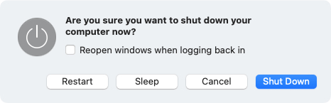

The problem with the display not waking continues but I have found a less disruptive way to wake things up.
On the Mac Studio I press and hold the power button for 1-2 seconds. This brings up a dialog box with options for Restart, Sleep, Cancel, Shut Down. Shut Down is the default but typing the letter S puts the Studio in Sleep mode. Wait about 5-10 seconds and then hit any key to wake up the Studio which also wakes the display. The nice thing about this method is I can do it even if I cannot see the display. So there is no need to pull the USB-C cable out anymore.
But I would like to see a way to prevent the problem.
