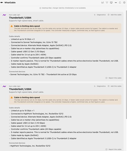

Nothing like curiosity to dig up what you’d rather not have known. So what does one make of this:
The cables are identical Apple TB3 cables w/ Apple TB3-TB2 adapters.
The Sonnet, the first device is (or was advertised) as TB2. The second, the RocketStor, never claimed more than TB1. Is it the cables, the adapters, false claims…
Not clear that buying a license will provide anything more useful.
