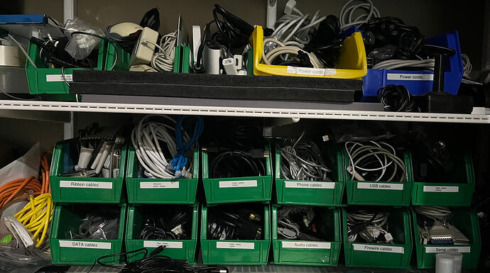

Since you asked. My parts closet is pretty well organized, but there are still a ton of random cables:
I do indeed label my cables (and adapters) when I obtain them if they’re made for higher wattage (100W or 240W) or higher throughput (40 Gbps) to distinguish them from just any old USB-C cable. The latter I readily throw out if it doesn’t serve a specific purpose or is very well manufactured. The former I tend to keep around. I will always end up needing a good TB4 cable for something.
