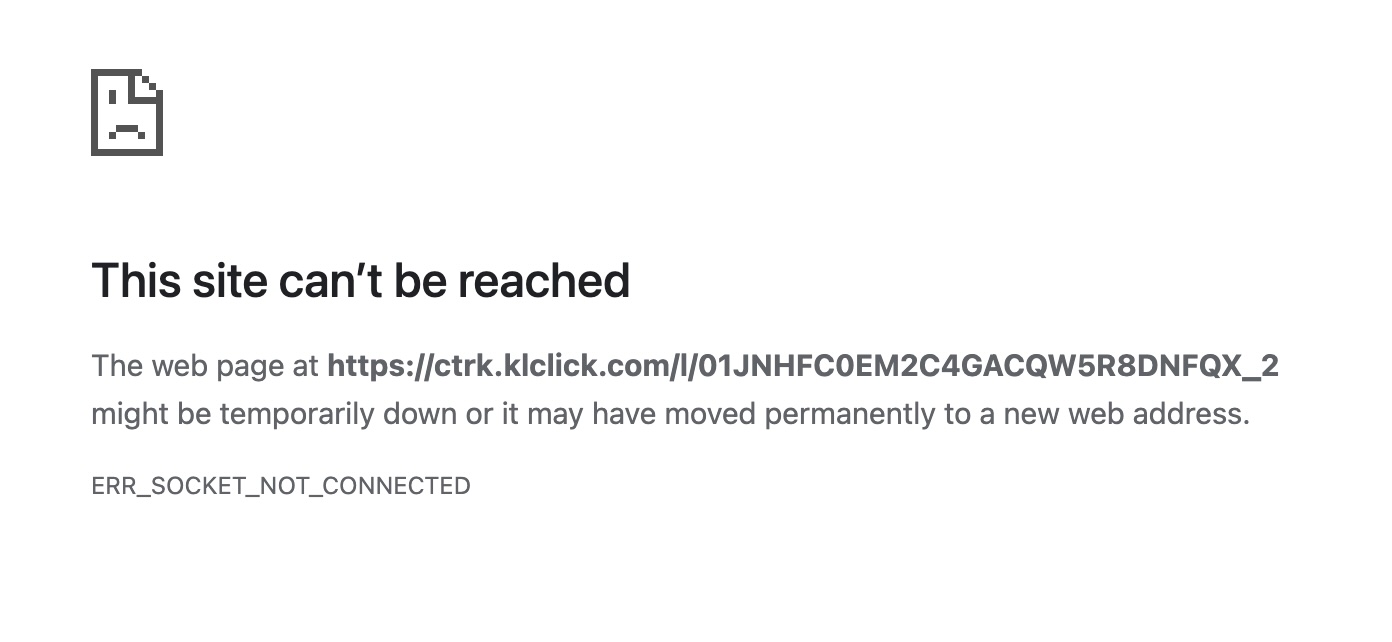

Several years back, I installed some form of ad blocker on my Mac. Basically what this blocker does is prevent me accessing (almost) all links directly from received emails.
Below is a copy of the type of message I get when attempting to click on an email link
I feel like a complete idiot as I am unable to even recall the name of this adblocker. I can’t even remember where I got the instructions to do this from!? Whatever, it is becoming tedious when I get a genuine email and need to type in my browser bar to get to a website referred to in an email. Searches using HoudahSpot, for numerous keywords including for ublock, adblocker, adguard, etc reveal nothing.
I would greatly appreciate some (any) advice on how to proceed.

Ron , thanks! I do recall that during the process of installation, I had an extremely long list of IP addresses/names like klclick, klclick1, etc - in a .txt file. However, my /etc/hosts is completely empty.
Also, to answer your question, if I copy the link/image/whatever in the email and paste it into a different browser, it still doesn’t work. So, for example, if I get an email from Goruck.com and click on it, I get the error message as shown in my first post. If I copy that link into a different browser, I get the same error message. However, I have zero problems if I type Goruck.com into any of my browsers

The link to kclick in the photo in your first post is a tracking link that goes to a GoRuck.com product page. I gather that you are comfortable typing on the command line. Try typing ping ctrk.klclick.com on the command line in Terminal.app. You will either get a successful response quickly or a delayed error message. If you get a successful response, you can rule out DNS configuration as the cause. If you get an error message, then the plot has thickened.

Yes, I am manually entering a different URL. If I cut and paste it from say a Goruck email it is in the format https://ctrk.klick.com/long alphanumeric string. To get to Goruck manually after seeing an email from them I type in Goruck.com
