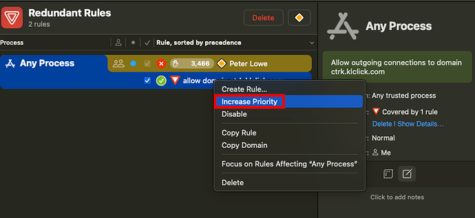

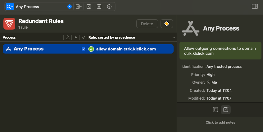

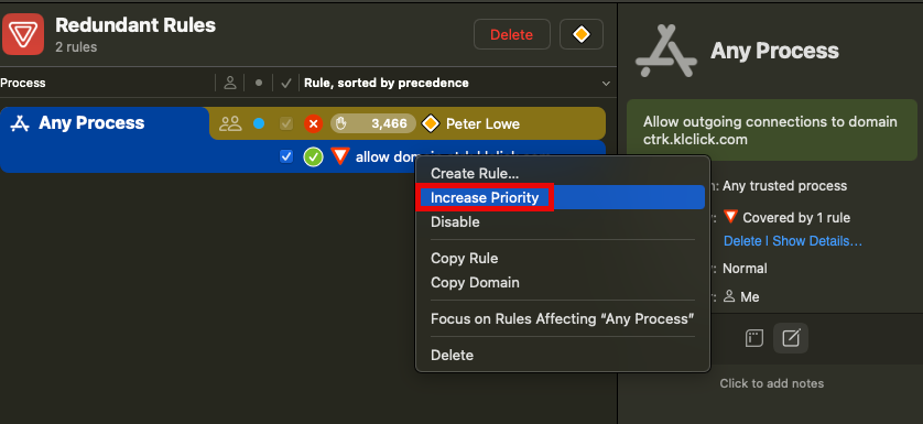

I had the same problem today, and found it in Peter Lowe’s blocklist. I don’t want to disable the blocklist, so here’s how I fixed it:
Click on Little Snitch in the menu bar and click on “Manage Rules…”
Click the “+” at the top.
Change the “To:” field to “Domains”, and then paste in “ctrk.klclick.com” instead of example.com, and click “Create Rule”.
Note that it now shows as redundant. Click “Show Details…”
Right-click the new rule, and click “Increase Priority”
Now that the Priority is High, it’s no longer redundant, and traffic to that specific domain will be allowed even though the rest of the blocklist continues to function.
