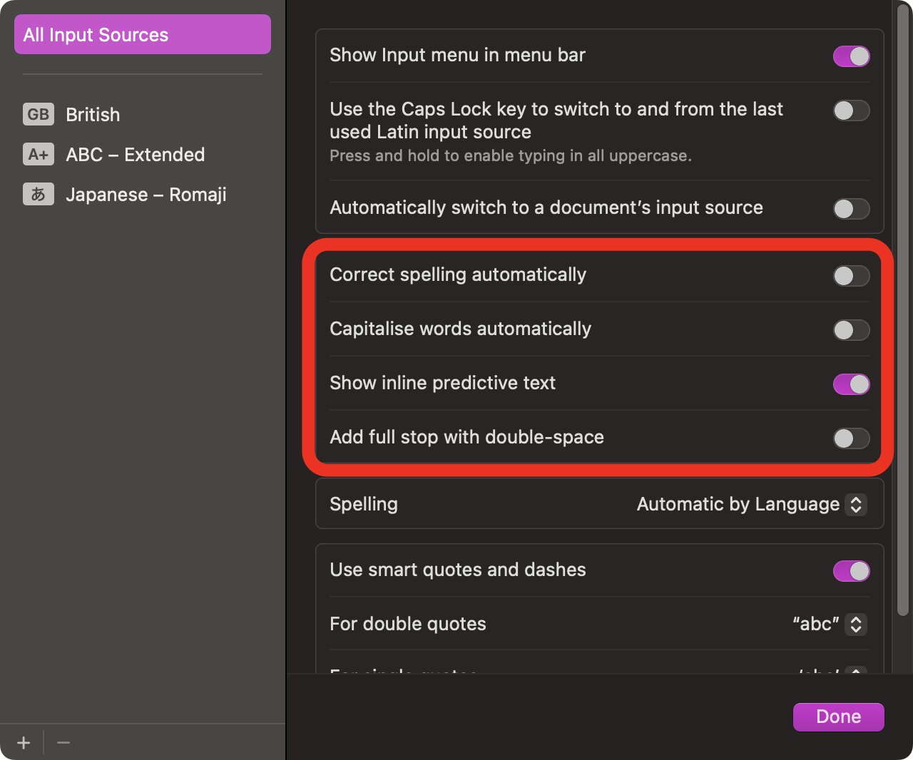

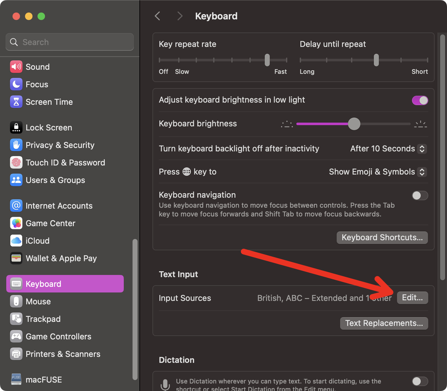

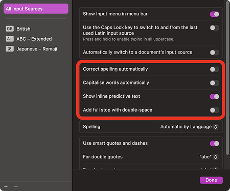

On a similar note, wish I could turn off Sonoma’s apparently system wide word suggestions forever. I’ve always hated those. I’m so tired of the system replacing “No” with “NO” in my text data spreadsheets forcing me to add a space to prevent the capitalization.
You can turn this off in System Settings. Go to Keyboard ➞ Text Input ➞ Input Sources ➞ Edit… and you can turn off options such as Correct spelling automatically and Capitalise words automatically.
Tried that before. Didn’t work. Thanks though. I tried it again just to be sure.
