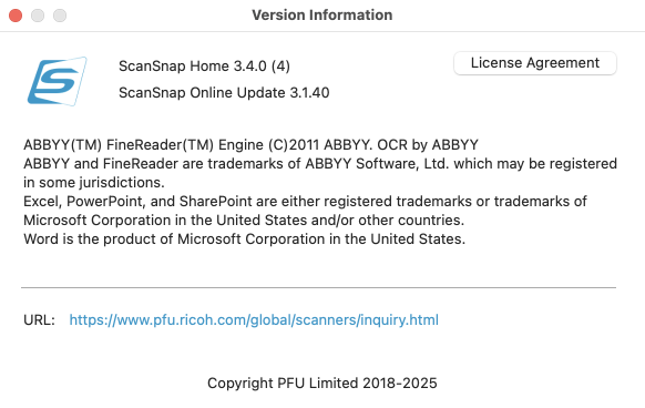

The latest version of ScanSnap Home iOS actually 3.4.0, but this will not work with older scanners (I tried it).
This page tells you what versions work with what scanners.

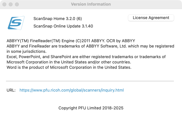

My IX500 is limited to 2.22.0, and apparently only supported up to Sonoma, but it works in Tahoe.
The link suggests that the S1300i is supported in Tahoe using 3.4.0

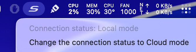

This reply is a bit misleading in my experience.
ScanSnap Home app can be used in two different modes “Local” and “Cloud”.
What is described by AI as ScanSnap “Cloud” is ScanSnap Home app used in Cloud mode. There is a switch in the menubar to change between Cloud and Local mode.
