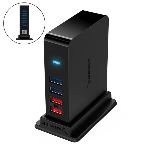

It’s not the hub, because I have an external SSD connected to it with my large Photos library on it and it’s working fine.
It’s not one or the other WD drives interfering with the other because I tried just mounting one at a time and leaving the other disconnected. That doesn’t work either. And I tried different hub slots.
