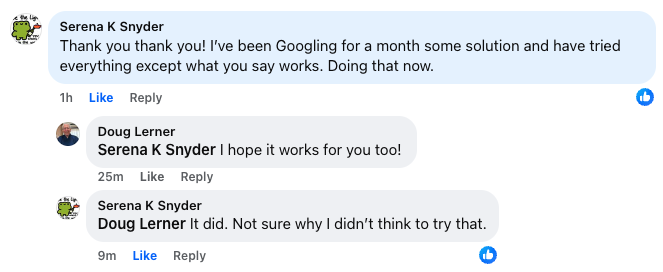

I posted my blog entry at Facebook and got a response right away from somebody else who experienced the same problem!
