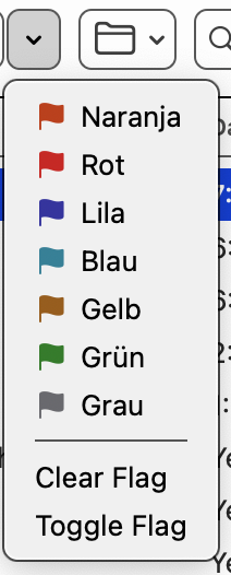

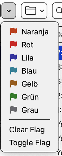

Weird side note: I have one persistent configuration weirdness that has persisted through both of the last two “clean” installs. The color names of the flags in Mail are in, I think, Dutch. I was at one point trying to get the localized string of a specific UI element in a number of foreign languages, and so I was changing the language setting in macOS to see what it was. (I’m sure there are easier ways to do what I did, but it was … expedient.)
When I finally went back to English, everything was back to “normal” (for a US English user), except the names of the flags in Mail.app, which remain in a foreign language. I suspect, but am not certain, that this is propagated via iCloud, since my process of migrating Mail’s folders is to export on the old system and re-import on the new machine. (Corrupt a mailbox once, you get paranoid.) I’ve decided it’s charming…
