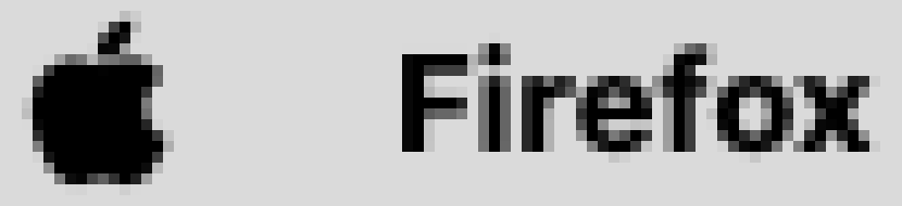

At Apple’s preferred size of 110 dpi, the system menu bar is 24 pixels tall, which is about 0.22" or 5.5mm. And the height of the Apple icon representing the Apple menu (including anti-aliasing pixels) is 17 pixels or about 0.16" or 3.9mm tall. A 220 dpi retina display at 2:1 scaling will have the same physical size (with twice as many pixels, of course).
A 160 dpi display without scaling will still have a menu bar of 24 pixels tall, but it will be 0.15" (3.8mm) tall and that Apple icon’s 17 pixels will be 0.11" (2.7mm) tall, which is 32% smaller. That display with 2:1 scaling will produce a menu bar of 0.30" (7.6mm) tall and an Apple icon of 0.21" (5.4mm) tall, which is 36% larger.

A 1440p display with no scaling will render content at exactly that resolution, but note that all text is anti-aliased anyway. So there will always be a slight amount of fuzziness, but you want that because jagged edges look even worse.
Note a zoom-in on the corner of my menu bar (on a 1920x1200 display with no scaling):
