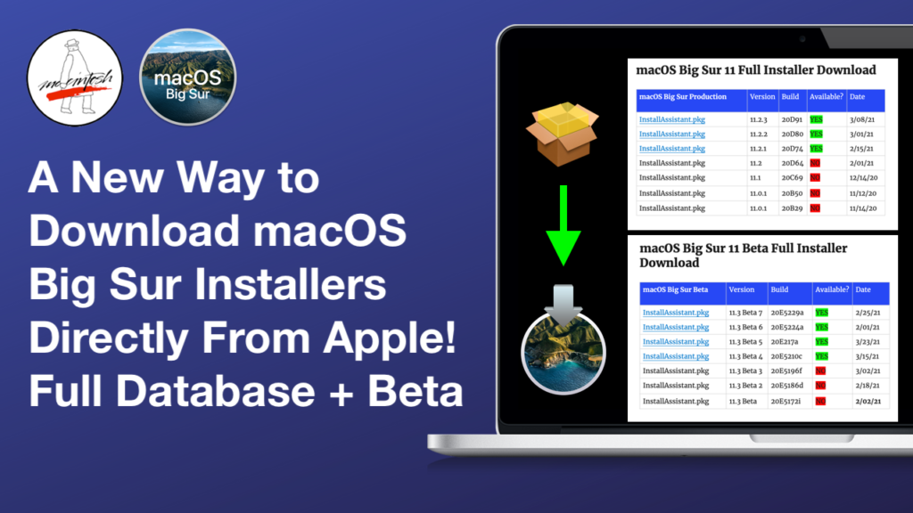

I found this site helpful:
No problems so far. Good luck with it.
No need to go to a private link database like this unless you want an older release of a particular macOS version.
Apple provides links to the latest release of each version from their own pages.

I searched Apple Support for ā€˜Big Sur installer’ ā€˜macOS 11.6’ etc. and got no hits at all. Deeply frustrating.
How did you find that page ?
MDS is a free third party app that will download any installer from the Apple servers.
It will also make a bootable installer using creatinstallmedia.
Sometimes you just follow your nose:
I started with the Support tab on apple.com. Then I selected the Mac section, then MacOS, then Reinstall macOS. The last section on that page entitled ’ Other macOS installation options’ had a bullet item ’ * Use the App Store or a web browser to download and install an earlier macOS.’ which had a link to the Apple page describing how to get the installer from the App Store.
Interestingly, searching directly for macOS BigSur on the App Store does not show it.
" . . .just follow your nose:"
Thanks, Alan. I think I’ll just follow my nose to the back of the class . . .
I guess I got lucky. It’s the first hit when searching for ā€œold macos installerā€:
https://duckduckgo.com/q=old+macos+installer
Searching for individual macOS releases is less reliable, because Apple doesn’t have a separate support page for each release - they only have pages for some of the oldest versions. The rest are special links to App Store pages.
