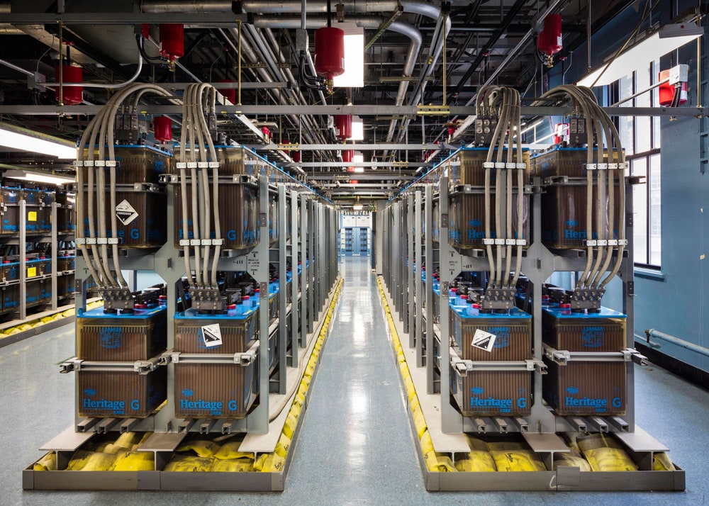

The legacy phone company virtually invented the U.P.S. (Uninterruptible Power Supply). To this day, their switching systems operate on -48VDC. That means all the computers, relays, backup systems and whatever else is required to produce dialtone and switch calls. The only thing NOT running off battery power is the HVAC for the building that houses the switch.
And it’s technically NOT a U.P.S. which, by design, SWITCHES to battery backup in the event of a “shore power” outage. The telco system runs 24/7 on a HUGE battery that is continuously recharged by rectified grid power. This is how, with more than a few exceptions these days, when the lights go out you can still place and receive calls on an old-fashioned telephone set that requires only a telco connection - no external power supply required.
Each cell of the huge battery I mention is about the dimensions of a 20-25-gallon cylinder. Each cell is of the flooded, lead acid type. Depending on the size of the Central Office and its switching equipment, the battery room can be VERY large, housing hundreds of such cells.

Take a look at this article from 2016:
The last photo (#14) shows the battery room of a large-scale central office in New York City:
