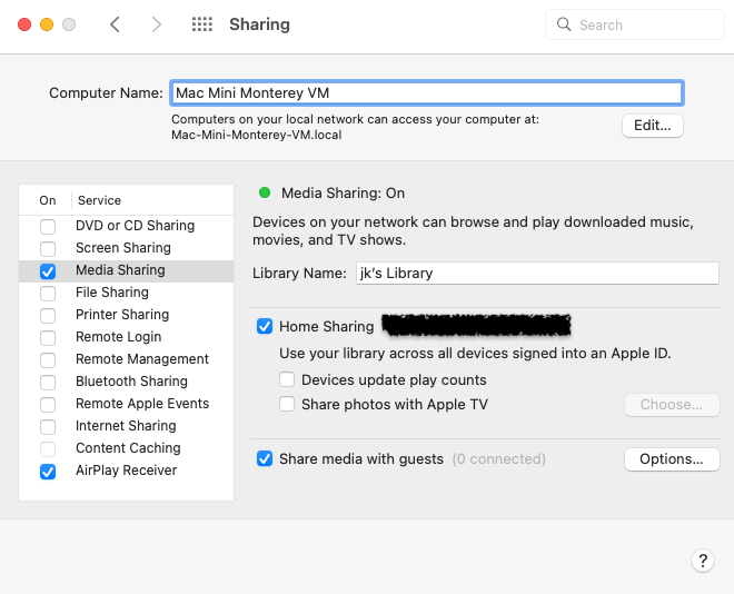

This is what it looks like in Monterey which should be similar to yours:
After clicking Options, you get this screen:

The Sonoma windows are slightly different than the Monterey windows, but now that I know what to look for, I was able to find “Share Media with Guests” and enable it.

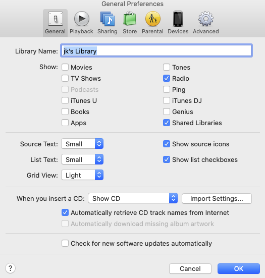

One other thing in iTunes: under Preferences/General, you need to have Shared Libraries checked otherwise they don’t show up in the sidebar.

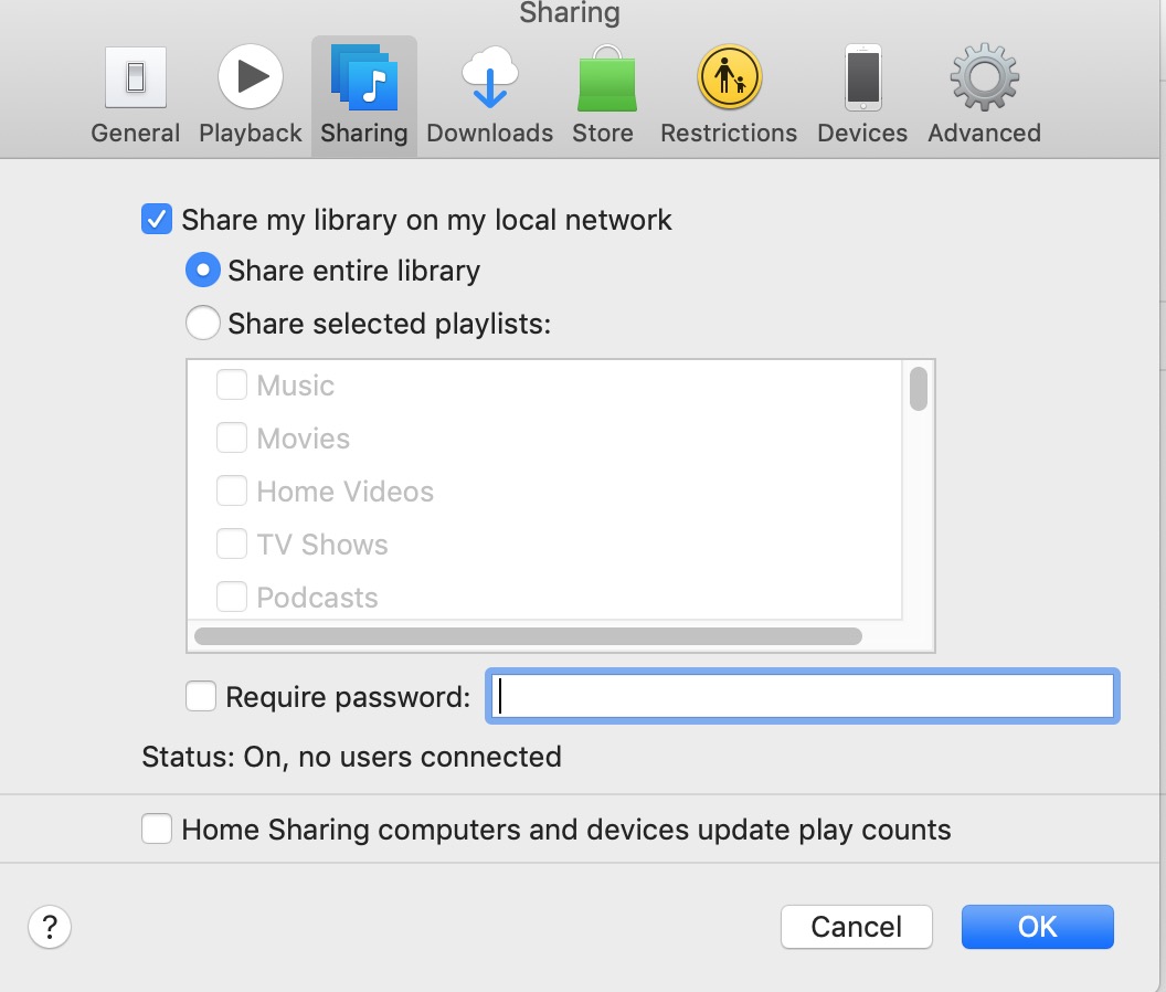

Under the Sharing tab, I do have “Share Library on my local network” turned on (photo also below).

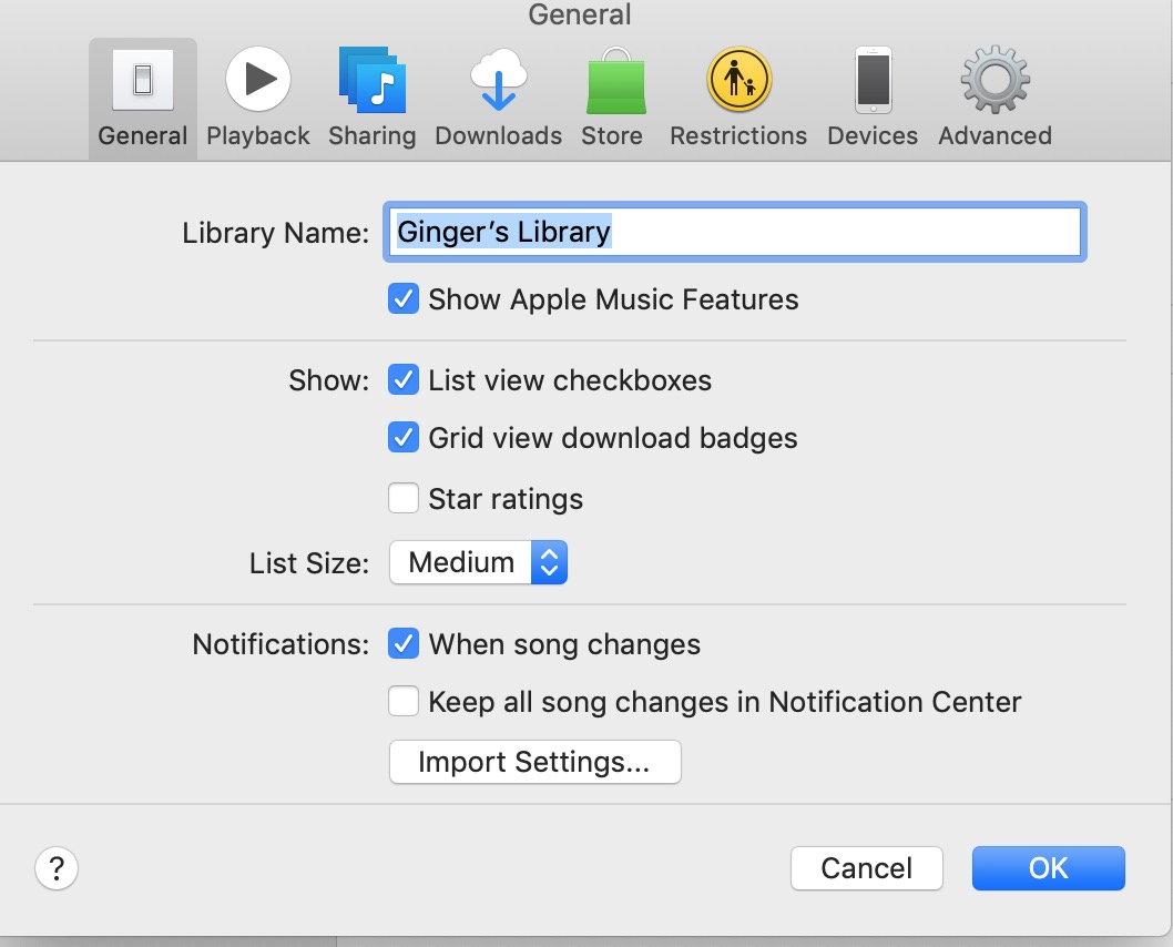

On the Mac Studio running Sonoma, the Music preferences “General” looks nothing like your example. (photo below)
