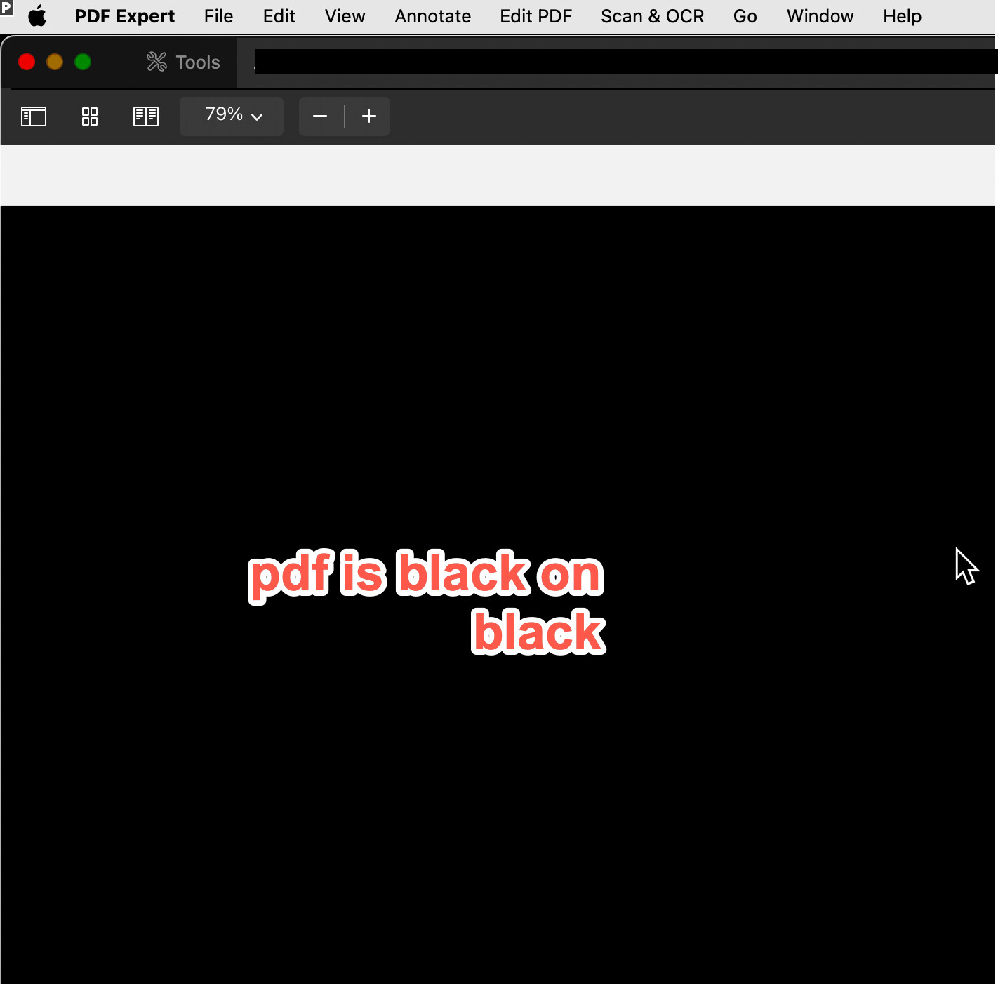

  • intermittently apple mail email body in the preview pane, as well as PDFs in PDF viewers (PDF Expert or other) are completely black (probably black font on black background) see below. When it happens in Mail, every second email is black in the preview pane as I go down the list of my emails. Usually when I open the email I can read the content. With the PDFs, the content can be black in one PDF Reader but normal in another.

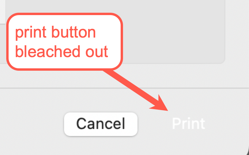

  • Sometimes buttons (like the print button) appear bleached out white (white font on white background), The button and inscription (for example print) is barely visible. See below

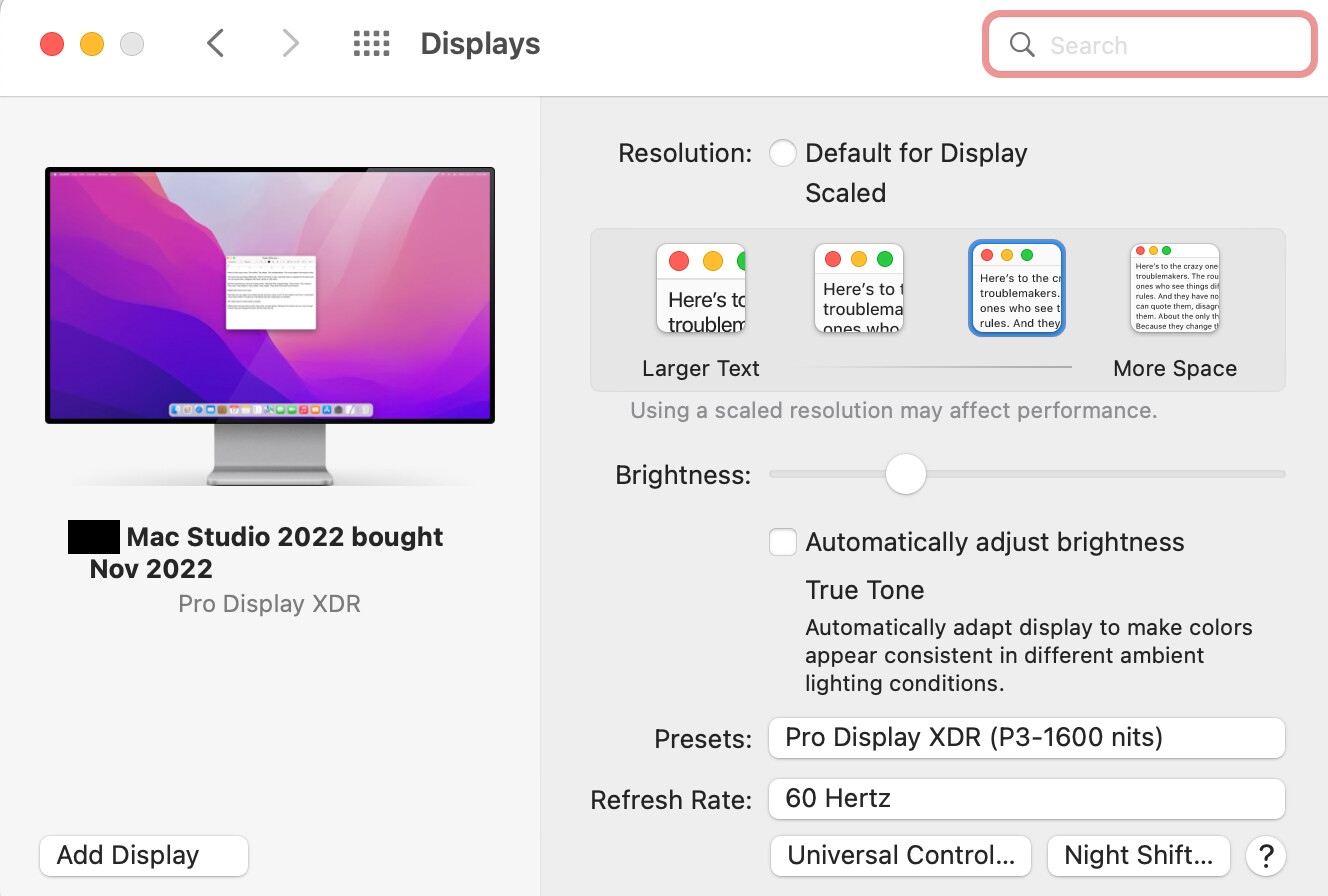

  • most solutions proposed on the Internet do not apply because they refer to sys pref > displays → color tab > calibrate, but this option does not exist in Monterey 12.6.8 see below
  • Electric Light Comply discusses the absence of refers of sys pref > displays → color tab > calibrate, which does not exist in Monterey and suggests running a file called Display Calibrator app in /System/Library/ColorSync/Calibrators Calibrating your display in Monterey – The Eclectic Light Company I carried out the procedure they describe, but the problem is unchanged.

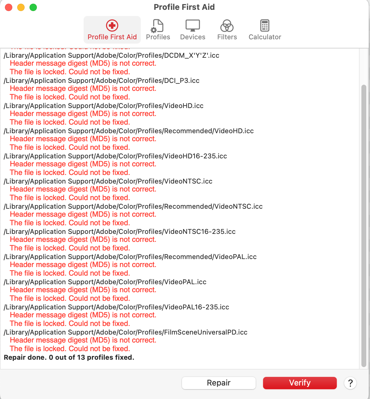

  • I ran the colorsync utility app → verify → found 12 problematic .icc files (below) → repair. The files could not be repaired because they are locked. I re-tried in safe mode to no avail.
