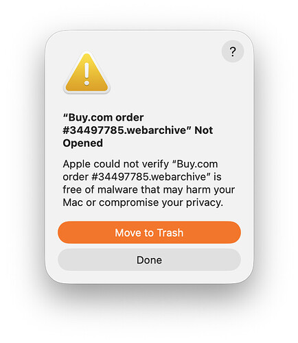

Dated 2007. Not helpful buttons. What I want open it effects be damned? What’s '“Done” mean?
I couldn’t open it with TextEdit or Nova. Same message.
Same result for another old .webarchive.

Could somebody having this problem try the following?
In Terminal, cd to a folder containing some of these problem webarchives. Type:
xattr -d com.apple.quarantine *.webarchive
Years ago, I had a similar problem with some webarchives, and for unknown reasons they had apparently acquired a quarantine attribute.

I downloaded this and I get the error you have been getting. I also tried “Open With…” and selected TextEdit and got the same error. However, if I opened TextEdit and then used the Open… menu it would open correctly.
A check of quarantine status:
dob> xattr -l Largely\ Forgotten\ Osage\ Murders\ Reveal\ A\ Conspiracy\ Against\ Wealthy\ Native\ Americans\ _\ NPR\ 2.webarchive
com.apple.FinderInfo:
com.apple.lastuseddate#PS: tK8j
com.apple.metadata:_kMDItemUserTags: bplist00�XYellow
5
com.apple.quarantine: 0083;6a384b1d;Safari;2B5BFF7F-02B2-4E4C-85B2-8263C3AE0CEE
And this removed the quarantine:
dob> xattr -d com.apple.quarantine Largely\ Forgotten\ Osage\ Murders\ Reveal\ A\ Conspiracy\ Against\ Wealthy\ Native\ Americans\ _\ NPR\ 2.webarchive
as shown by this followup:

Quarantine just means Apple can’t verify where the file came from. If you downloaded it from the internet, copied it from another Mac, unzipped it from an archive, etc. it might be flagged. Quarantine does not mean there’s anything suspicious or wrong with the file, just that’s unknown.
If these are your webarchives, there’s probably nothing wrong with them. They are just old and unknown, and somehow got flagged. Just turn off the quarantine bit on them and they should work fine.
