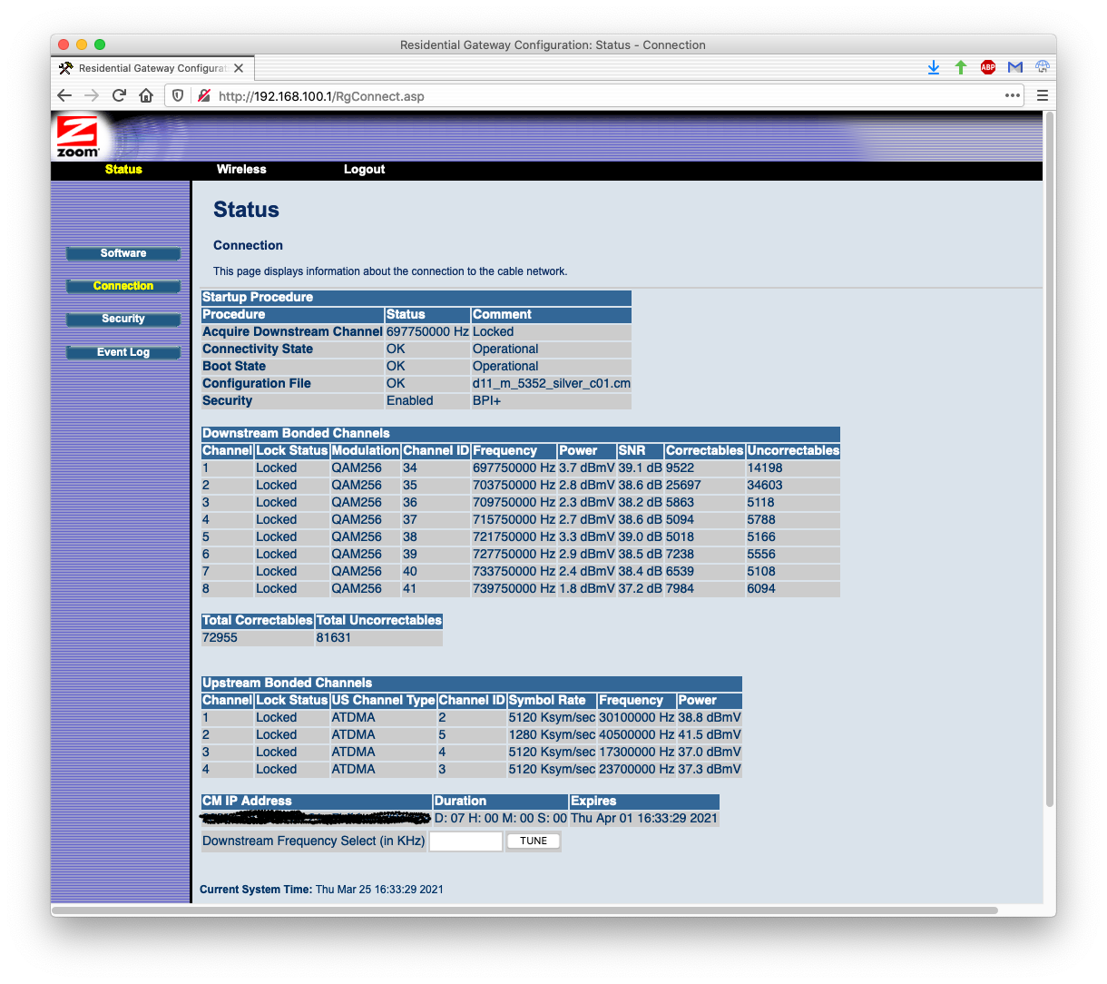

If you have the access credentials, you can often log into your modem and check its status. It will show you information about your current connection. For example, here’s what I get when I log into mine:
In it, you can see that my modem supports 8 downstream (from the ISP to me) channels and 4 upstream (from me to the ISP) channels and that it has successfully connected (“bonded”) to all of these channels. This produces a theoretical maximum bandwidth of about 300 Mbps downstream and 100 Mbps upstream - which is appropriate for the service I’m paying for (100 Mbps downstream and 5 Mbps upstream).
My modem, however, is pretty old. Newer ones, especially those designed for gigabit Internet speeds will allow many more channels. For example, one on Comcast’s approved list supports 32 downstream and 8 upstream channels for a theoretical maximum bandwidth of 1.2 Gbit/s downstream and 200 Mbps upstream.
Anyway, the reason for my mentioning all of this is that the cable has many more channels than your modem supports. When it connects to the network, it connects (“bonds”) to a subset of the available channels and it typically won’t try to switch channels unless there’s a complete outage (which would cause it to restart the entire connection process when the network comes back). If there is a network problem causing a channel to drop out, rebooting the modem might cause it to bond to different channels after the reboot, which might improve your throughput.
But all this is conjecture. The technology is not hard to understand (at least at the high level I’m explaining it at), but only your ISP will have the diagnostic tools and network access needed to properly diagnose line conditions.
