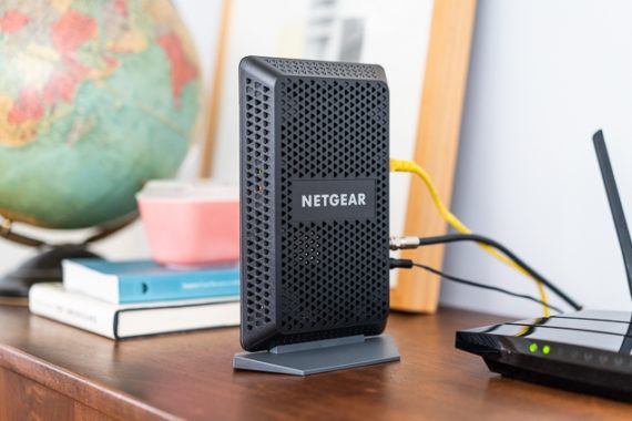

A couple years ago we had no choice but Comcast and I knew I wanted to keep using my AP Extreme. I bought a Netgear CM500 cable modem on Amazon for $87 (at the time). On arrival, I plugged the coaxial cable into the box and it worked pretty much right away. I definitely didn’t need Comcast’s help to get it to run. I think at the time it was listed on a Comcast site as being compatible.
https://www.amazon.com/gp/product/B00R92CEVU
It was a cheap plasticy crummy little modem, nothing fancy, but it did what it was supposed to. It wasn’t fast either, but still faster than the downlink Comcast promised so I was OK with that. To be honest, that part never gave me any grief. A lot of other Comcast shenanigans did so as soon as I could I dumped them for fiber (Sonic) and have been happy ever since. Comcast operates like the mob. I vowed never to do business with them again. Ever.
By the way, for less than what I paid back in the day, you can now get what Wirecutter says is the best cable modem, a Motorola MB7621 for $78. Their runner up is the successor to the Netgear modem I bought a few years ago. And their budget recommendation is actually the model I bought.
Just be sure you are using a modem that meets the appropriate Docsis standard. Below gigabit, Docsis3.0 should be fine, but if you have or anticipating upgrading soon to gigabit level, you will need a modem compatible at the Docsis 3.1 level (note that higher level compatibility implies lower level compatibility. I used a Surfboard SB6190 until my service level went up. I am currently using a NetGear CM1000 that I got on sale with no issues. Note that what matters is the Docsis standard, not the speed rating on the box. Of course, I am noting modems which have Internet service only; very few of these commonly available modems also handle voice.
I got one of the recommended ones…Motorola something or other for our gigabit speed connection…and it worked out of the box just fine.

I’ve been using the Netgear Nighthawk CM1150V Docsis 3.1 Cable Modem for the previous five months ($229 from B&H Photo) with my Xfinity service, and it has worked fine. I previously used my own modem, but it was Docsis 3.0. Since I am now getting faster internet speeds, I decided to upgrade to Docsis 3.1. The problem was finding a Docsis 3.1 Cable Modem with voice. This was the first one I found. I’ve had no problems at all since I installed it.
The only downside is the cost. At $229, the payback vs. rental is longer than I’d like, but there are few choices and they’re all expensive at the moment. I’m sure the price will drop once there are more choices.
