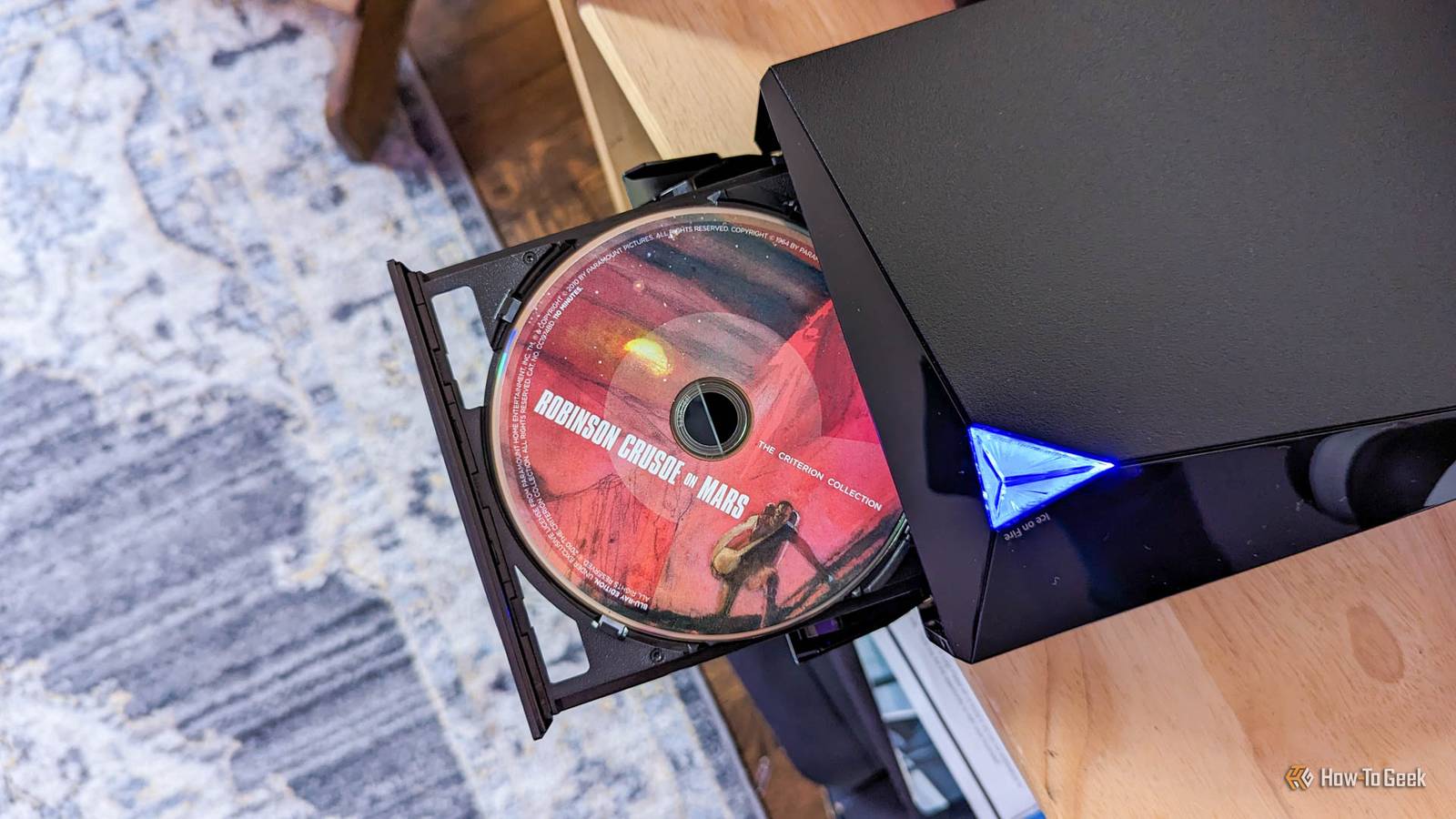

Alternatively, one can a DVD burner/reader that’s powered off of a wall socket, as opposed to running off USB.
Admittedly, this isn’t an optimal solution for on-the-go disc burning/reading. But for desktop Macs, it’s nice to know the drive has the power it needs — even if you’re calling on it to burn an MDISC Blu-Ray.
