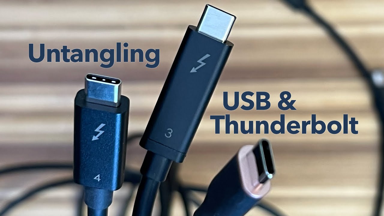

I have made a video that’s pretty dense (my first outing of this kind) about USB and Thunderbolt compatibility, ending with an explanation of why the Thunderbolt 4/USB4 cable is the best you can get for the least amount of compatibility worries.

This is the first time I ever watch and infomercial from end to end. Good Job, Glenn.
That’s superb Glenn. Well worth sharing widely.
What is the A in the lower right corner? Curious.
Oh, that’s funny. When embedded, I think it drops in my overlay image, which is an A for Aperiodical. It doesn’t appear on YouTube. Maybe there’s a configuration settings I missed.
