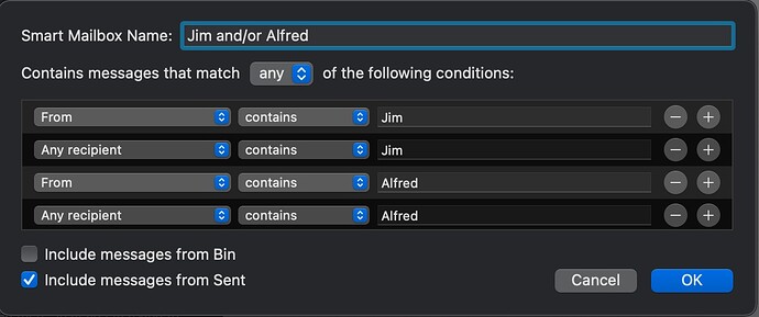

The setting shown below finds approx 890 emails, but I expect only under 30. Most of the 890 emails found have nothing to do with Jim or Alfred. The logic is that it finds all mails younger than 1 July. I can change to âmatch ALLâ instead of âmatch ANYâ , but doing so finds nothing.

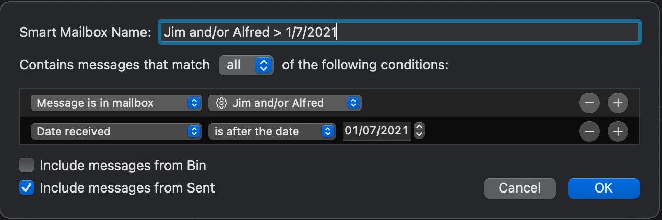

This set of conditions will show you all emails after January 7, 2021. Because the conditions for a Smart Mailbox canât contain a combination of âanyâ and âallâ conditions, you need to set up two Smart Mailboxes:
The first one will have the âRecipientâ conditions and similar âFromâ conditions and with the âanyâ modifier. Call it âJAallâ. The second one will have two conditions with the âallâ modifier. The first one should be âMessage is in Mailbox JAallâ. The second one will be the âDate Receivedâ condition.

1 - Use two smart mailboxes. One that gathers all messages for Jim or Alfred, then a second smart mailbox that gathers messages from the first one, based on date. (or just sort the results of the first one based on date and ignore the older messages.)

On balance I still think Smart Mailboxes are confusing and not easy to use, not exactly Appleâs finest hour. To search for a sender, you need to search for âany recipientâ, this makes you think youâre doing the opposite of what you want, because a recipient is somebody I send TO, not receive FROM. You think at first you canât search for âdate sentâ, but using âdate receivedâ does exactly that.

So⌠you need two Smart Mailboxes. First to get mail from Jim AND/OR Alfred. Second, to limit the date range. The nice thing about this, is that you can change the date range in seconds, whenever you want. Not bad compared to moving stuff around manually.
The one you view, is the 2nd of the two. The first one just sits quietly in the background somewhere. (N.B. Any/All)
