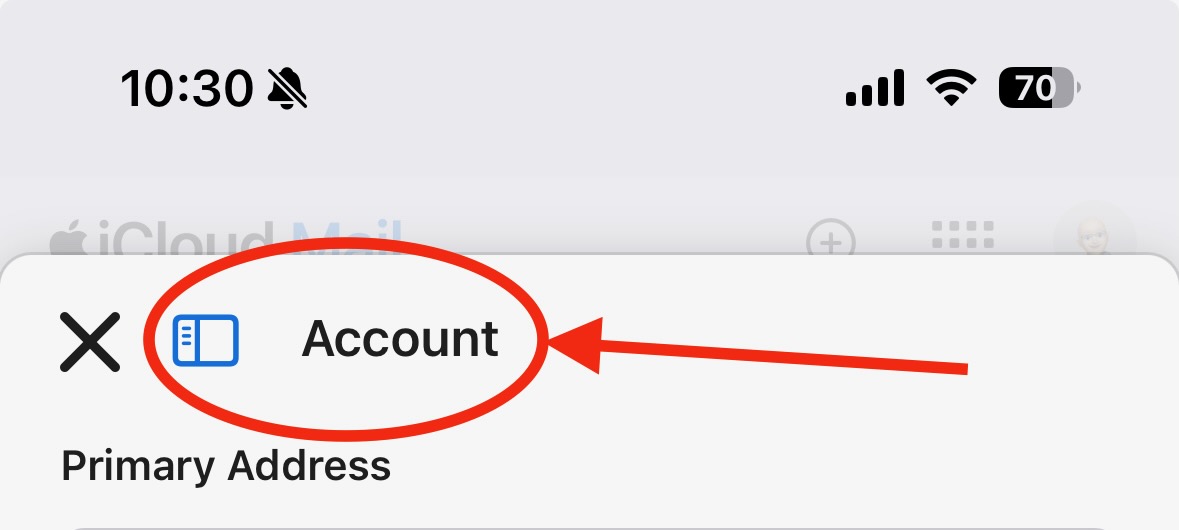

First of all, just to make sure that I didn’t mess myself up, I created a new Safari profile for the secondary iCloud account in Settings / Apps / Safari. Then in that profile I logged in to the secondary iCloud account, went to mail. This opens the In Box view - to get to settings you click the back button to show All Mailboxes, and this reveals the settings icon.
This is where it gets less obvious. This opens the account settings, but there doesn’t seem to be a place to change rules. This took me a minute to find, but you tap the control that says “Account” at the top of the screen to reveal the page for Rules settings. Generally I don’t pile on to the UI/UX simplifications that Apple has instituted since iOS 7, but this one was particularly inscrutable - it’s basically tapping the “sidebar” icon that Apple has added recently, but it was non-obvious to me.
Here is a marked up screenshot showing where to tap:
OK, got it. I’m using VoiceOver and so is Pete, but thanks to your description I’ve figured it out. This is doable if fiddly.
I wish the native Settings UI were available for secondary accounts, that’s clearly much easier, but he’s willing to sign in on desktop already so, although it isn’t as nice (especially without passkey auth), it should still be possible for him to manage it all on iPhone now.
