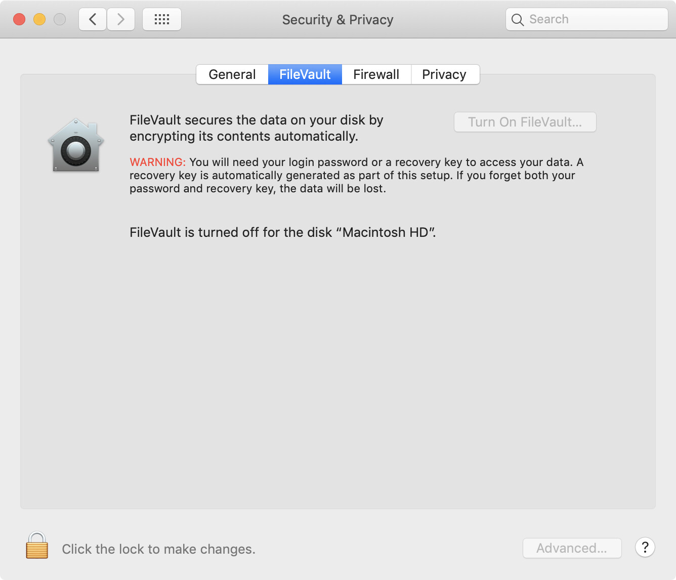

The laptop’s never been encrypted, though; I’ve never touched FileVault. I double-checked, afraid that the hard crash had corrupted something, but according to System Preferences I’m still unencrypted:

Really stumped. It’s continuing to fail to update every hour without any error message - it seems like the warning about encryption only happened after I deselected and then reselected the target drive, which makes sense as a trigger, even if the message is wrong about the source being encrypted.
