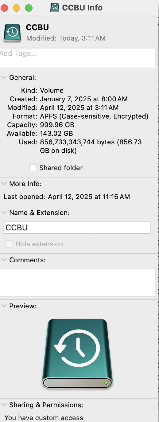

What does “Get Info” say about the drive when this happens?
APFS. Here’s a screen capture of the Get Info window on the drive.

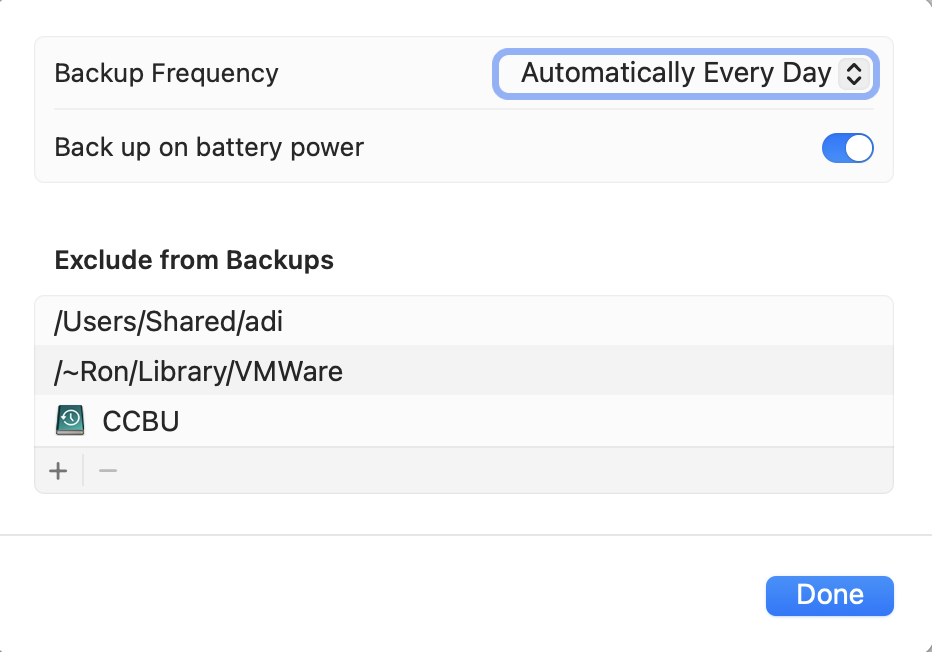

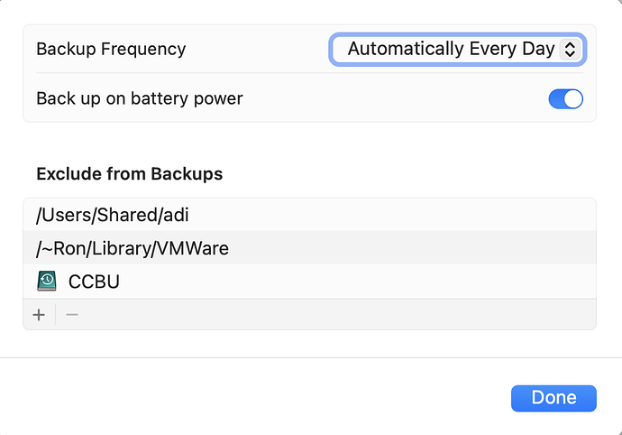

Here is the System Settings dialog box for Time Machine with the password option nowhere to be found. Nothing on the configuration side changed which would have precipitated the password setting no longer being available.
Am I missing something?

It looks to me like your Time Machine drive is encrypted and has mounted successfully.
I don’t think I’d worry about anyone accessing information on your drive if it fell into the wrong hands. Since this is full disk encryption, data is decrypted when read from the disk, and encrypted before it’s written. The data on the drive remains encrypted at all times. Nor would I worry that the encryption password is stored on the drive itself. (that could be verified by attaching the drive to another Mac – it should ask for a password to mount the volume).

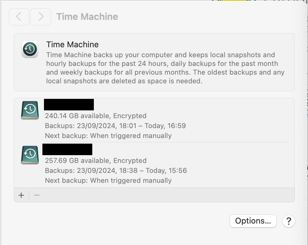

Whenever I attach a backup drive I get prompted for the password. System Settings confirms the backups are encrypted – See Screenshot 01.

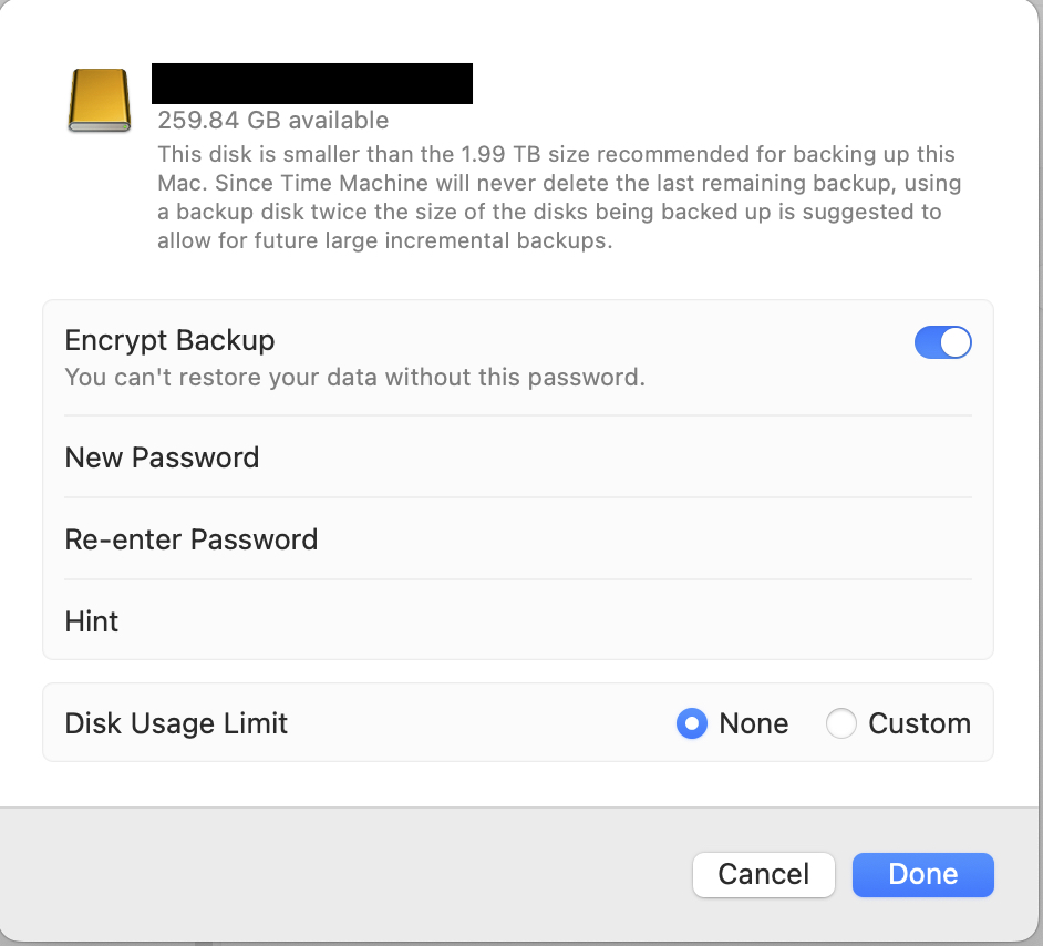

If I go to use a new drive for Time Machine it asks me if I want to encrypt it – see Screenshot 02.

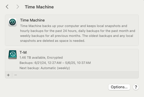

Top level panel in Settings>General>Time Machine:

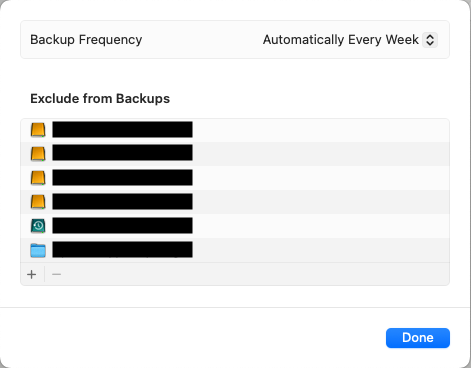

Options… panel under the Top level:

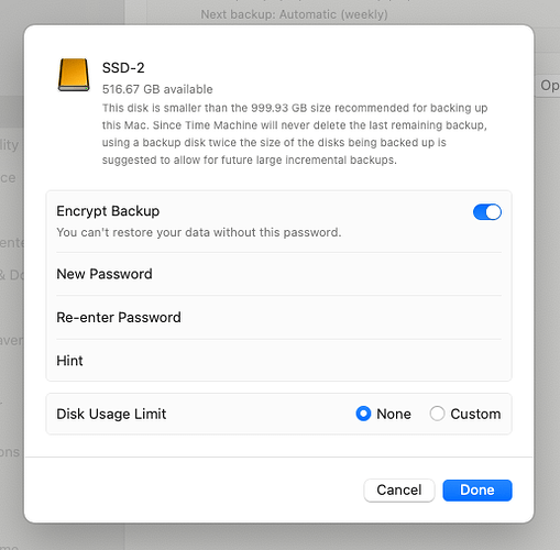

Only when clicking the + button in the Top level panel to create a new disk will you see this floating dialog:

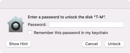

A password is requested each time the disk is mounted, until you check the box to Remember this… which stores the password in Keychain and allows direct mounting. Even here though, the option to edit the password is not available:
If your encrypted T. M. drive is mounting directly that means the password was stored in Keychain. This can happen unintentionally by clicking anywhere on the sentence “Remember this password in my keychain” adjacent to the checkbox.

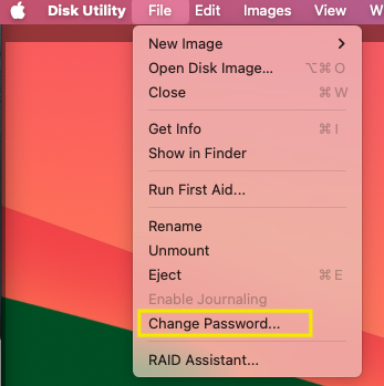

Once encrypted, the only place to edit the password is in Disk Utility:
