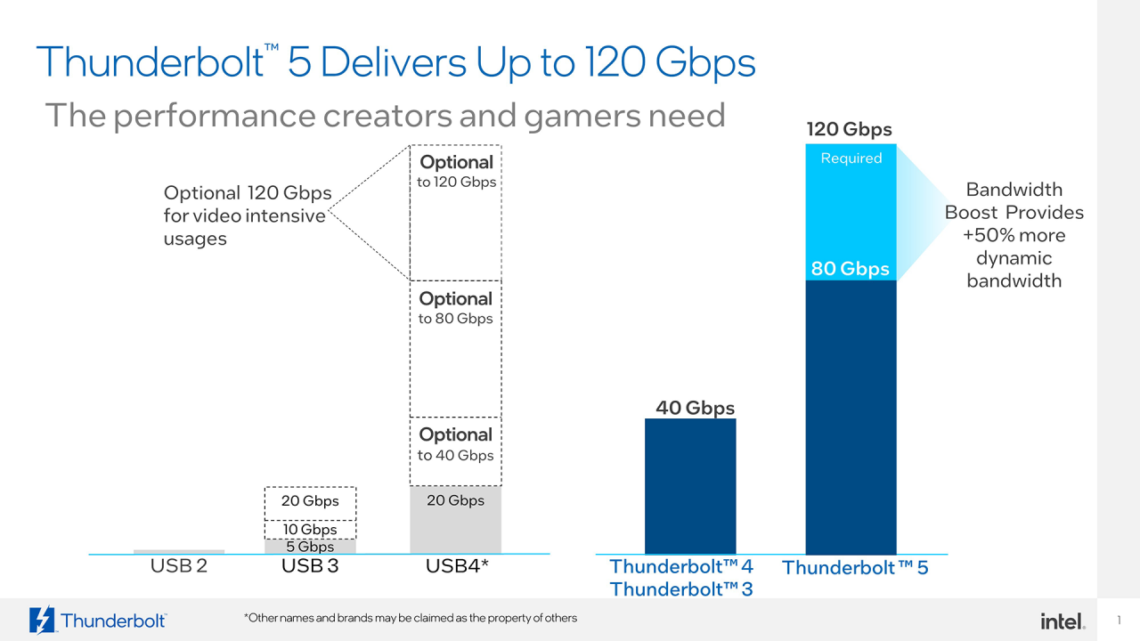

  • Twice the total bidirectional bandwidth
    • A “Bandwidth Boost” feature (not sure what that actually is) provides an additional 40 Gbps (120 total) for video-intensive usage.
  • Double the PCIe data throughput (presumably from 32 Gbps to 64 Gbps)
  • Built over USB4 V2, DisplayPort 2.1 and PCI Gen 4
