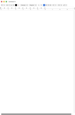

TextEdit refuses to show full width no matter how wide I drag the window. When opening a new window in TextEdit, there’s always a horizontal scrollbar (centered), and on opening an existing file, some text lines are cut off at either the beginning or the end, depending on the position of the scrollbar (it’s centered upon opening). Has anyone else seen this? Fix/work-around/suggestions?

Perplexity.ai answered that question for me: Toggling the ruler off (⌘R) “fixed” it for the moment.
