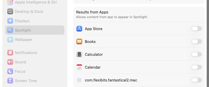

This thread got me to look at Spotlight settings, and I see that Tahoe reset all of mine, including enabling sending my search info to Apple. I’m losing my edge, I used to check all settings by default after a major OS upgrade.
Furthermore, it is indexing a process that shouldn’t be there, and I can’t figure out where it’s from:
“com.flexibits.fantastical2.mac”
I haven’t run Fantastical or anything from them in years. And Spotlight can’t show it to me, nor Find Any File…

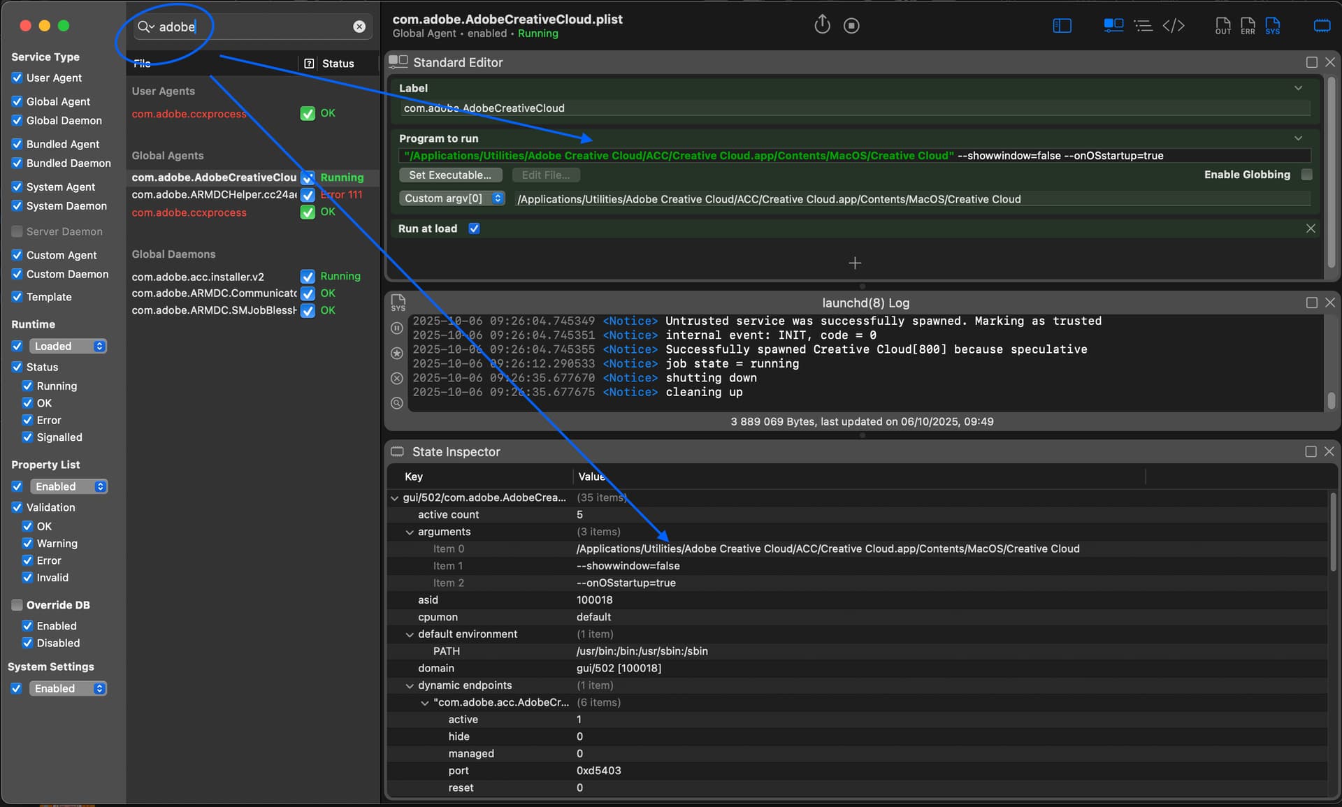

The application LaunchControl can help you find that.
When you know the path you can use the following command in terminal to disable it. Use ' ' if there are spaces in the path. Depending on where it is you might have to use sudo.
launchctl unload '<path found in LaunchControl>/com.some.developer.plist'
sudo launchctl unload '<path found in LaunchControl>/com.some.developer.plist'
Thanks, I’ll give it a try. (I think I still have a license… :-)
You do not need a license to search. A license makes it easy to edit launch filles.

Having traded some email w/ the Flexibits folks, they now believe it’s a Tahoe bug.
