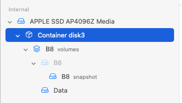

Is this what you mean by the macOS container? Asking for a friend…
Yes. The container that contains macOS and its Data volume.
On an Intel Mac, there is normally only one APFS container, containing several volumes, including:
  • macOS (which is snapshotted to create the SSV that is actually booted)
  • Data
  • Preboot
  • Recovery
  • VM
There’s also a separate EFI partition that is not an APFS container.
But on an Apple Silicon Mac, there are three APFS containers, each containing several volumes:
  • Apple_APFS_ISC (the lowest-level boot loader, which locates and boots macOS, both from internal and external media)
    • ISC Preboot
    • xART
    • Hardware
    • Recovery
  • Apple_APFS_Recovery. The Recovery mode you get if you boot the Mac when there is no macOS installed
    • Recovery (fallback)
    • Update
  • Apple_APFS. The installed macOS system, functionally equivalent to what you find on Intel Macs.
    • macOS (including the SSV snapshot)
    • Data
    • Preboot
    • Recovery (the one you get when booting to Recovery mode on a Mac where macOS is installed)
    • VM
If you want/need to blow away an Apple Silicon Mac, you want to delete the Apple_APFS container, but do not touch the Apple_APFS_Recovery or Apple_APFS_ISC containers.
I’m not sure Disk Utility will let you try to delete these two containers without jumping through hoops, but you shouldn’t try, because if you succeed, you will brick the Mac until someone can use Configurator (from another Mac) to restore it.
