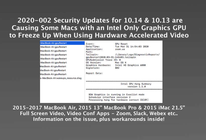

Has anyone run into this problem? I just heard about it from a reader, who thinks Security Update 2020-03 might have resolved it.
The issue started for me (ie this is where I noticed it first) with scrolling in Firefox causing the machine to freeze for some seconds to a minute, and then sometimes to shut down hard. Parts of a browser window (Chrome and Firefox) would flash while scrolling, and some video had problems too.
2020-03 seems to have fixed the issue for me for an iMac 2015 running Mojave and a MBP 2011 running High Sierra.
But …
I’ve just had the first kernel panic I’ve ever had on the iMac which seems to have happened while Chrome was executing. Much too early to say if this is related [once is coincidence, etc].
Keith
That happened to me twice in the last month. However, as far as I understand the installation log (About This Mac > Overview > System Report… > Software > Installations), I installed Security Update 2020-002 on March 25, and the problem didn’t start until a couple of weeks ago. Maybe I was just lucky for a while.

I don’t think, based on my experience anyway, that it’s a question of luck :grinning:. It’s more a question of what you ask the machine to do, it was FAST scrolling which seemed to trigger the problem for me, so if you’re a slow scroller you’re probably less at risk!
