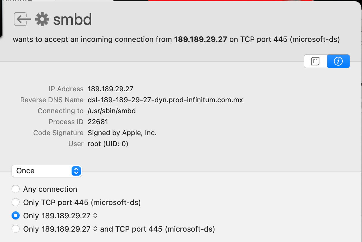

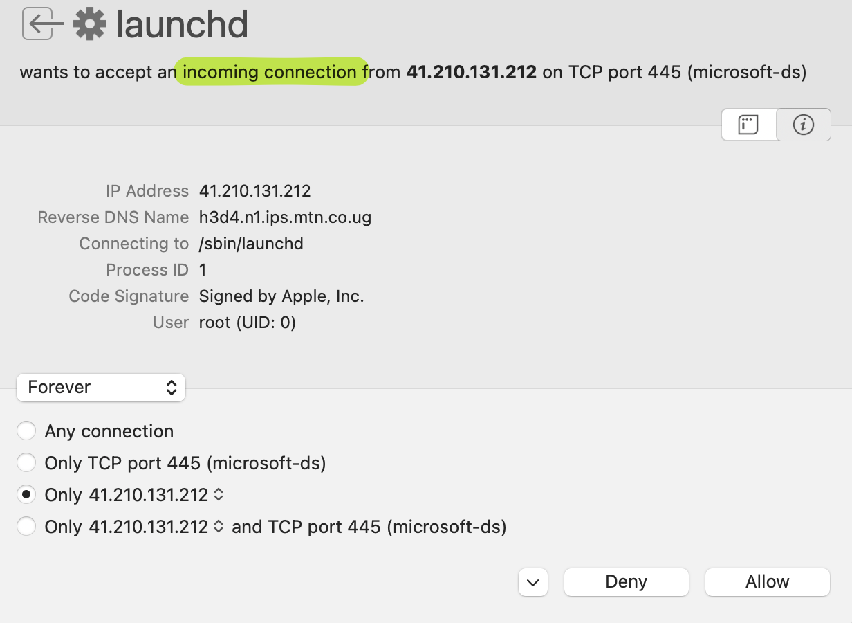

Hi friends, here at home, I normally connect to the internet via a router, which I have set up to block malicious and random traffic. I’m currently testing a 3-month trail of a 10GB fiber ($55/month) connection to see how it compares to my 1GB ($69/month), and have it directly connected to my 2023 MacBook Pro via ethernet. I’m running Little Snitch, and it’s crazy to see the number of random attempted connections that I’m getting to Launchd, Control Center, kdc, smbd, and the like.
I’m curious, for those that aren’t using a router (which probably isn’t many) other than running Apple’s Firewall how else are protecting your computer from internet connections and attacks? Using Little Snitch, I’m able to deny all of the connections that I’m receiving, but for those that aren’t using Little Snitch or a router, what are you using?

Yep, I understand all about NATing, inbound and outbound traffic. In this instance, however, Little Snitch is stopping inbound traffic, which is why I asked about Firewalls. These are connections that Apple’s Firewall deemed appropriate and accessible because of the type of Service that is being attempted. Macs do phenomenally well on their own in the DMZ, but I’m also curious what other means people are using to protect their devices when not behind a router.
Is that a BlockBlock pop-up for an incoming connection?
Little Snitch looks a bit different.
Anyway, BlockBlock is an option for some additional protection.
