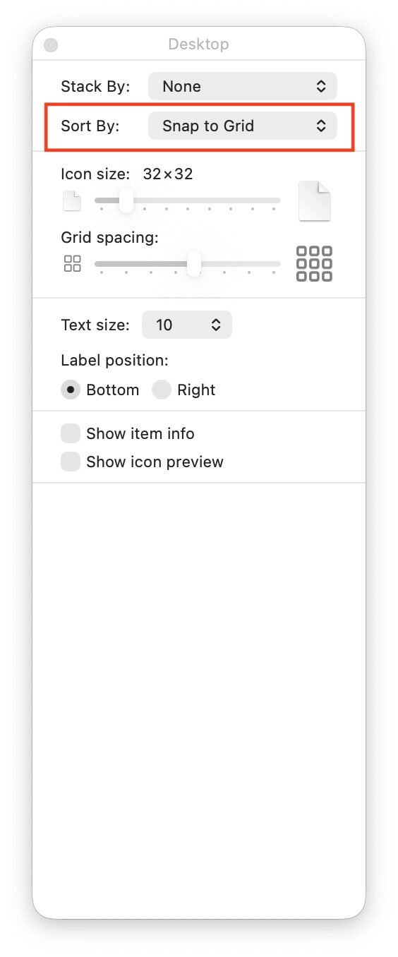

If you don’t want to re-order your icons, you can CMD-drag them, and they will snap to the nearest grid-points (as defined by your desktop/folder’s grid spacing - View → Show View Options).
You can also set a folder to Sort By: Snap to Grid, so ordinary drags will always snap the coordinates to grid points:
The behavior also shows up when selecting snap to grid (which I’ve always had). That makes it even more aggravating.
