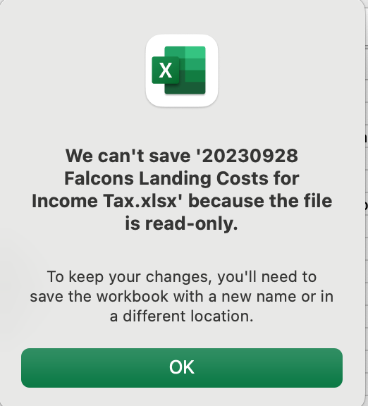

The error message:
David Tuma

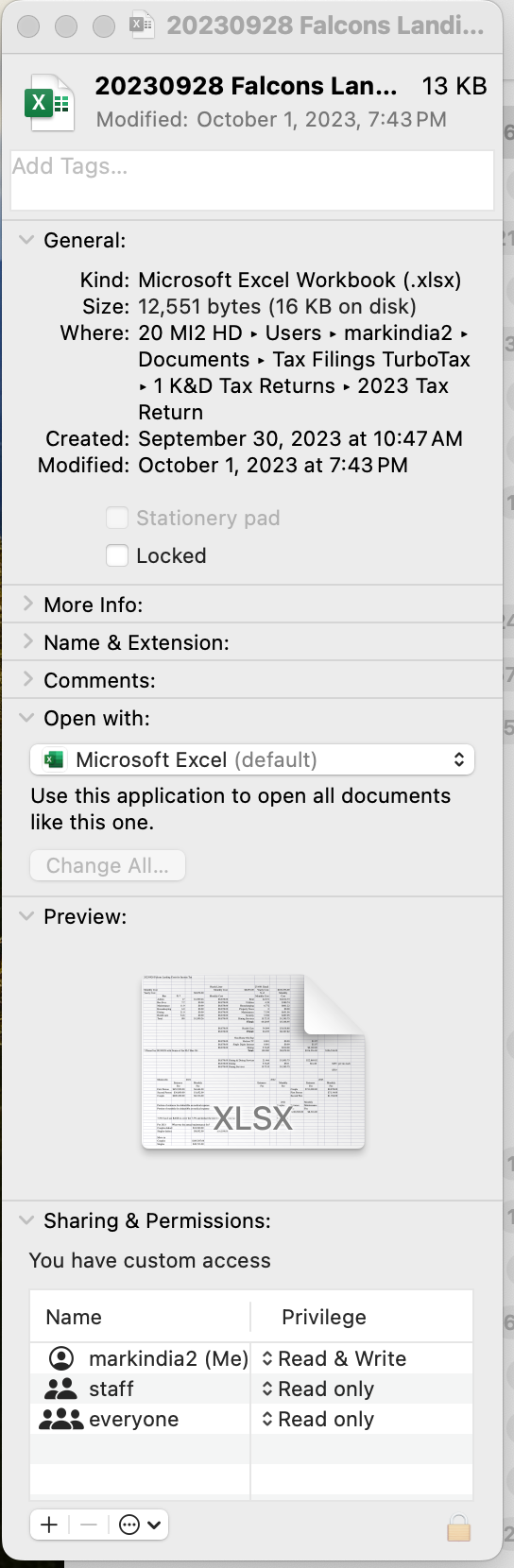

My folders and some files say I have “custom access”
One other thought. Check the permissions on all the folder containing the documents. You should have write permissions to that.
File hierarchy:
Users:
System has “R&W"
I can’t add my user (markindia2) - don’t have necessary permission
User (markindia2)
Shows I have “R&W” and I can make changes to those who have access
Documents
Tax Filings TurboTax
2023 Tax Return
Excel file

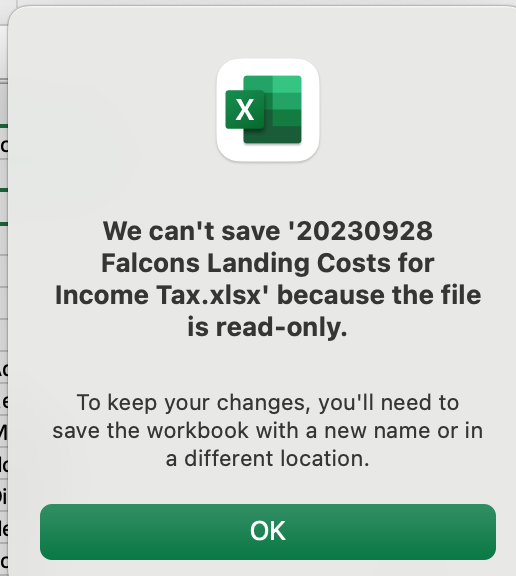

When I try to save changes, I can’t.
I get:
David Tuma

I get this from Excel periodically, if you just save as with a new name it will fix the permissions. So not the permissions from the computer but from Excel .
Lynn

If a file is writable but its folder is not, an app can write (and overwrite) the contents of that file. But in this situation, it can not create a new file in that location.
Many apps will not overwrite a file when you save it, but they will create a new temporary file. Then they will replace the original file with the temporary file (using the replaceItem API, which will preserve permissions and ensure that no data loss occurs).
If the temporary file is created in the same location as the original, then it will need write permissions for its folder in order for the procedure to work.

Top level, my SSD Internal HD says I have read only - won’t let me change as I don’t have necessary permission
Next level down is “Users” - it only allows “read” won’t let me change as I don’t have necessary permission
Although I can get to the section to make changes, I can’t add me as the admin because I can’t make a change.
In Sharing & Permissions, they both show:
System: Read & Write
Wheel: Read Only
Everyone: Read Only
Can’t add or change the ones there.

On my M1 Mac mini (Sonoma) and 2014 Intel Mac mini (Monterey), the root permissions are the same as yours,
However, on both the permissions on /Users for mine are:
system: Read & Write
admin: Read only
everyone: Read only
The user group for the /Users folder is not ‘wheel’ in a fresh macOS installation. IMO that needs to be fixed - and not by adding yourself to the access control list of /Users.
No user except the root user is a member of wheel. If your user account is set up as an admin, you are a member of the “admin” group, not ‘wheel’.
(the sudo CLI command as distributed with macOS keys off of membership of the ‘admin’ group and not ‘wheel’. - it’s likely that anywhere that you need to enter an admin password also keys off of membership in the ‘admin’ group).
Also the user folders in the Users directory have:
: Read & Write
staff: Read only
everyone: Read only
Please open terminal and cd to the directory where this spreadsheet is.
Then provide the output to ls -ln <filename>. Because of the spaces, you will need to wrap the file name in double quotes or else use tab to help finish typing the name.
Then provide the output to id.
The goal is to find out if the uid (not the name) of the file matches “you”.
