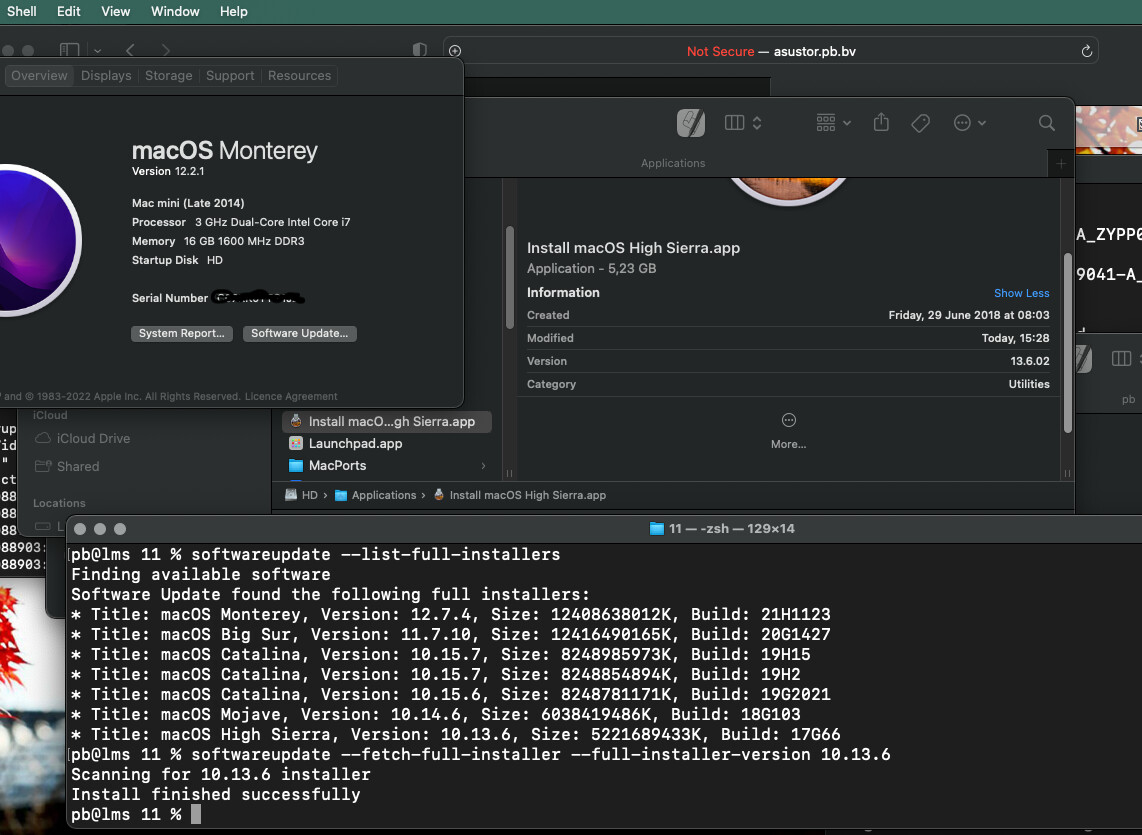

I have got a lot of problems lately with downloading old OS from apple servers, so it does not come as a surprise that you concluded it was not there anymore. You can still download 10.13. I just did.
As you see, this is on a Mac mini that is on Monterey. The downloaded OS is in the Application folder. The installer did not start installation.

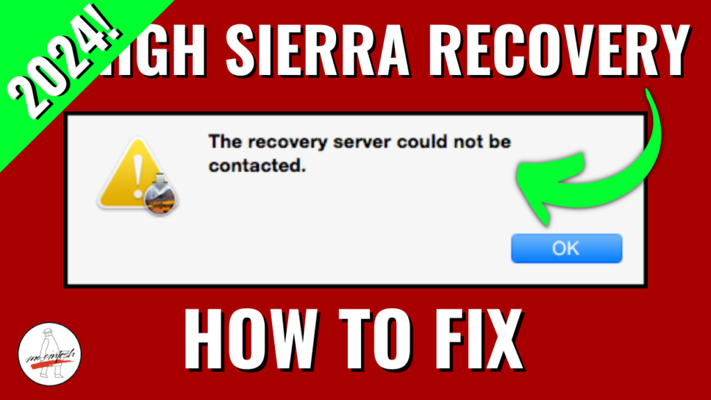

Is this a possible solution to the Recovery process error that has been mentioned? I once used Fix #3 successfully.
Looks like the same problem. Interesting to see it has been around so long. My fix worked so I will stick with it.
