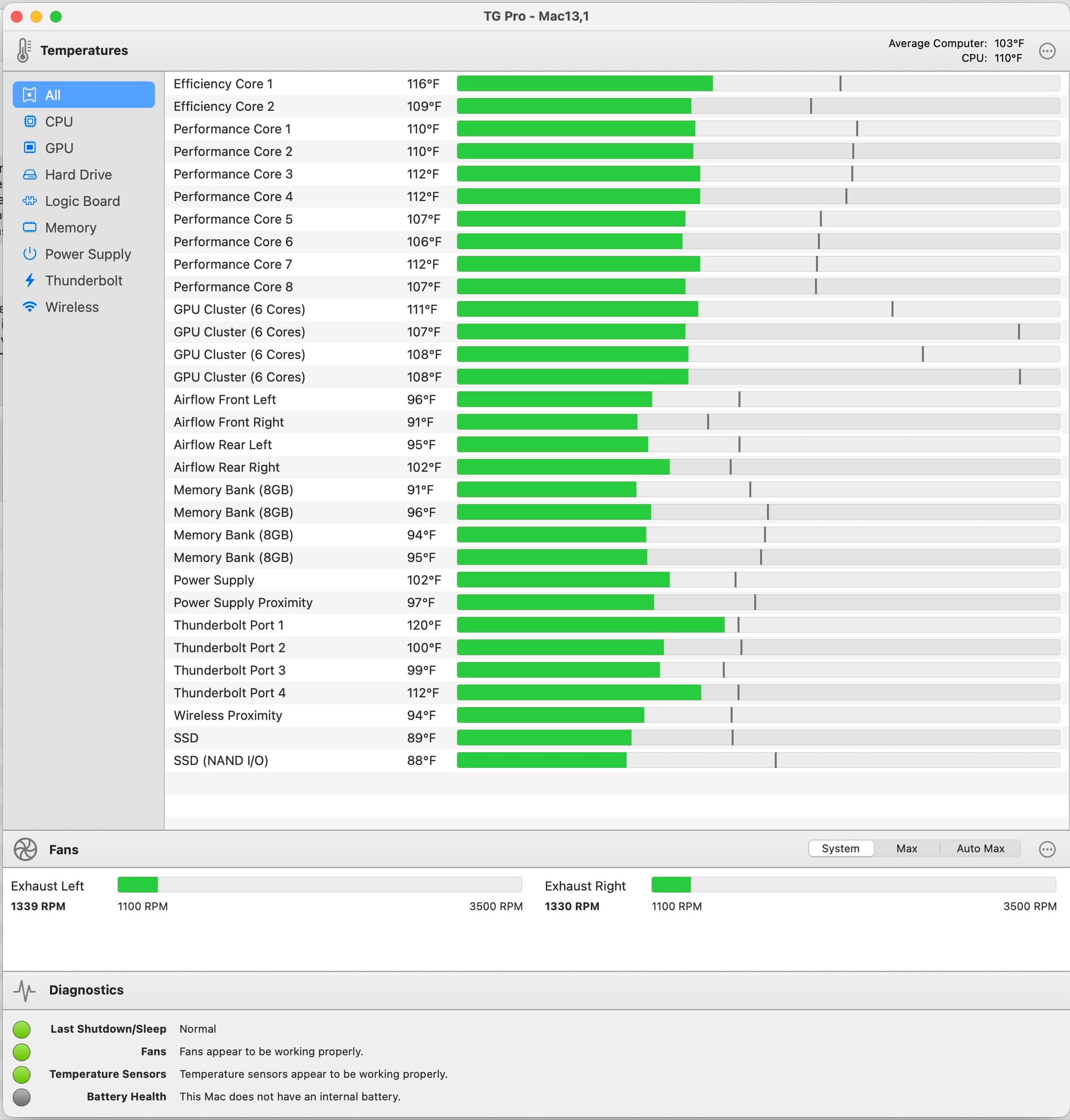

I use a program called TP Pro that I got for my MacBook Pro 2012 when I installed an SSD (with no temperature sensor which the Apple drive did have). TP Pro can ramp up the fans at steps in temperature. I don’t do that with this computer, but it helped on the MacBook Pro. Attached are the numbers that I get in my M1 MacStudio:
