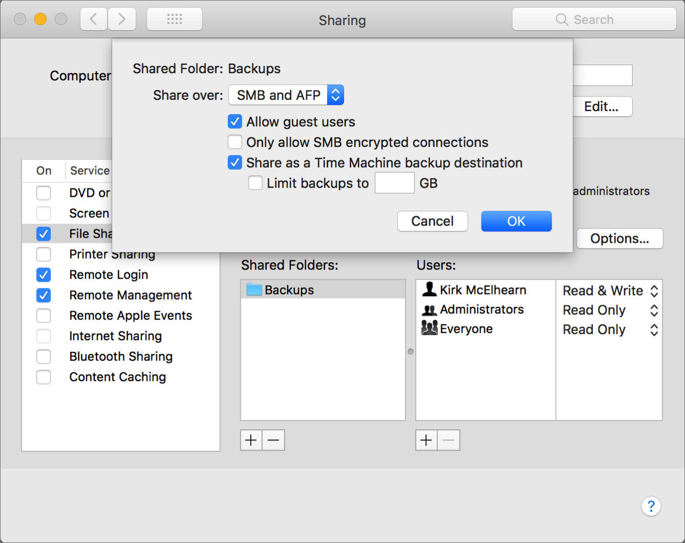

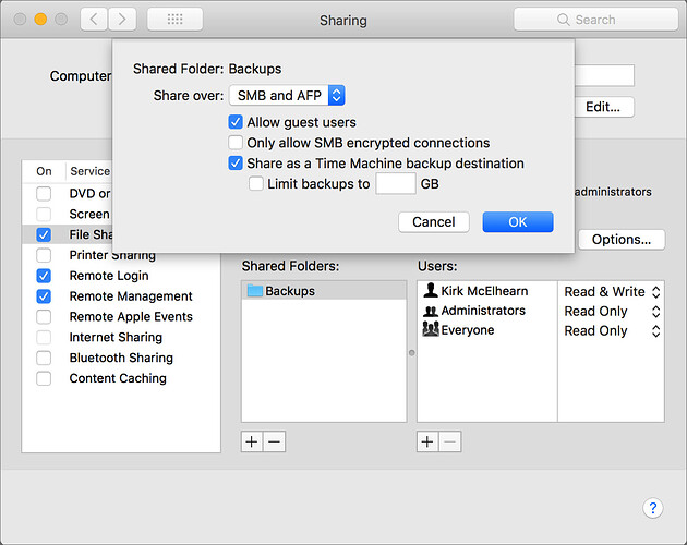

Time Machine Server does still exist in Big Sur (I like the way Apple now has a menu selector for system version in the User Guide, but they really should add screen shots, I keep having to make my own for users confused by text):
Back up to a shared folder with Time Machine on Mac - Apple Support
I helped a user set this up a few months ago when he wanted to start using his apartment building wifi instead of comcast. The TC was at least 7 years old and the drive was well past its typical lifetime anyway, so I had him stick it in a closet as an archival backup and get a spinny hard drive for time machine server on his 2012 mini. It’s been working out well for two minis and two macbook airs (all on Mojave).
