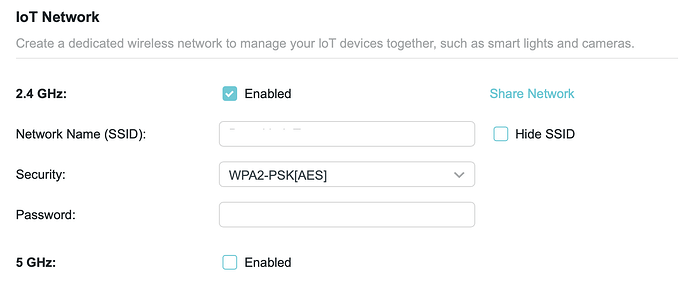

I see that my router (TP-Link Archer BE400, also referred to as BE6500 Dual-Band Wi-Fi 7 Router) offers the option of using separate SSIDs for Internet of Things (IoT) and Guests.
On this router, the IoT and Guest SSIDs each have unique frequencies, passwords, and authentication protocols. But the primary SSID, as well as the IoT and Guest SSIDs, draw from the same IP address range, so I presume the SSID doesn’t segregate traffic.
So what is the advantage of creating multiple SSIDs?

Correct:

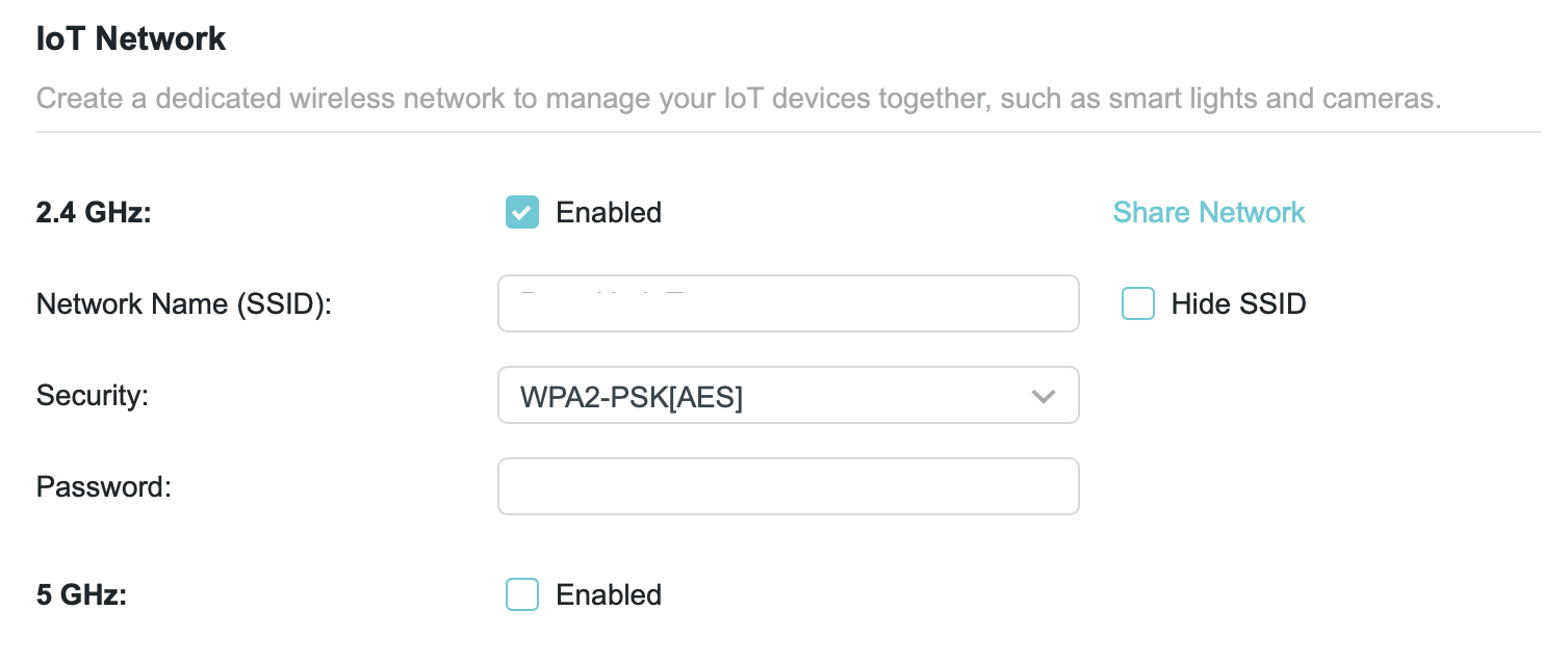

I do not see the same permissions configuration block as for Guests:
Thank you for the suggestion; I’ll give it a try.
