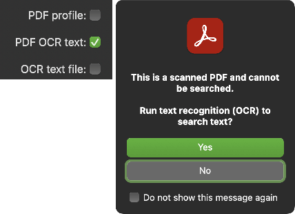

Hamrick’s VueScan has a checkbox to ensure that all PDFs are text-searchable and indexed by Mac Spotlight.
Should you ever find a PDF with non-searchable text, Adobe Acrobat will fix it for you. Works a treat.
