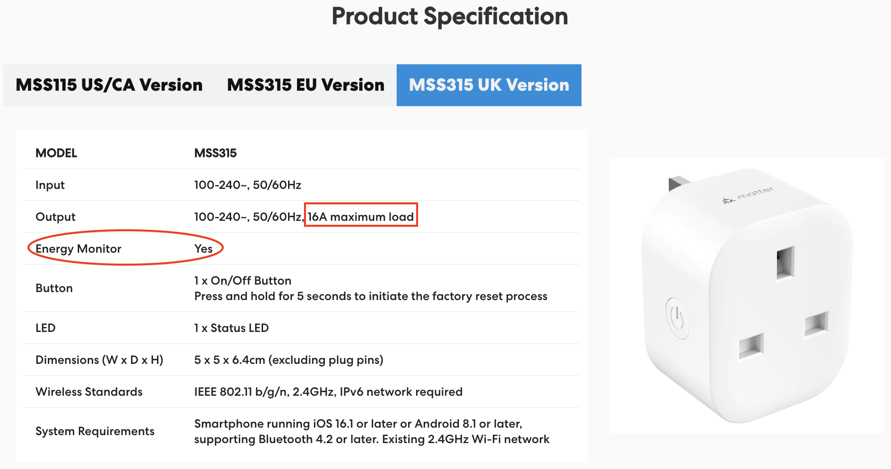

I have a matter plug that I purchased 2 for $25. Works great under homekit (with no software installation or anything special) to control our air cleaner. Unfortunately, it doesn’t have enough amps/watts/volts/whatever to power our espresso machine. From what I can see so far, the matter thing is working (at least for me).
That’s odd, as it shouldn’t matter (no pun intended) what device is plugged into simple on/off smart-sockets; the power connection should just pass through. Guessing these are the Meross ones?
Oh yes I remember, you’re limited by the N.American 120V system.
UK/EU 240V means a higher 16A :
I have a 4-pk of the previous smaller UK HomeKit-only versions. They’re semi-OK for network reliability over distances from my 4K ATV box via WiFi, but I do wonder if these (new improved™!) Matter ones would work better, as they have the newer Thread networking compatibility?
EDIT 1: Meross’s newer Matter smart plugs also come with with the extra energy monitoring feature.
EDIT 2: Just noticed, for US/CA folks, your version does not have energy monitoring.
Well that’s dumb :(
What is…the lack of 16A or the lack of energy monitoring? Both I guess, though the former probably can’t be helped, while the latter does seem a weird omission. :person_shrugging:
Espresso machine motor probably starts with a current spike that very briefly exceeds 10A that trips the smart switch. Otherwise your house wiring might be at its limits and causing a voltage drop that can also cause a current spike.
