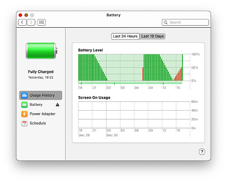

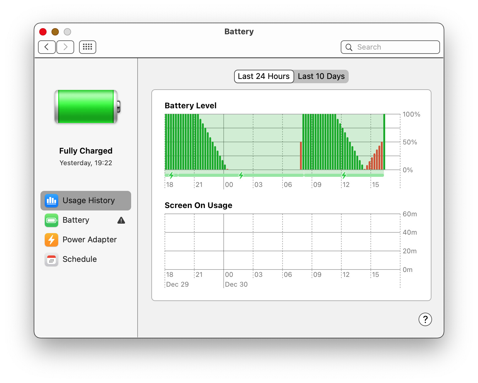

Last month, my MacBook (Retina, 12-inch, Early 2015, MacBook8,1) started discharging its battery overnight, even though it was plugged in. (It would recharge after I coaxed it to awaken.)
I reset the System Management Controller and that fixed the problem—for one night. After resetting the SMC, the MacBook behaved normally for the rest of the day and the next day, but the following day (today), it was back to its problematic behavior. I don’t know if it’s significant, but the history did not show the “ramped” discharge that I had seen before. On the other hand, I only have one instance of discharge since resetting the SMC.

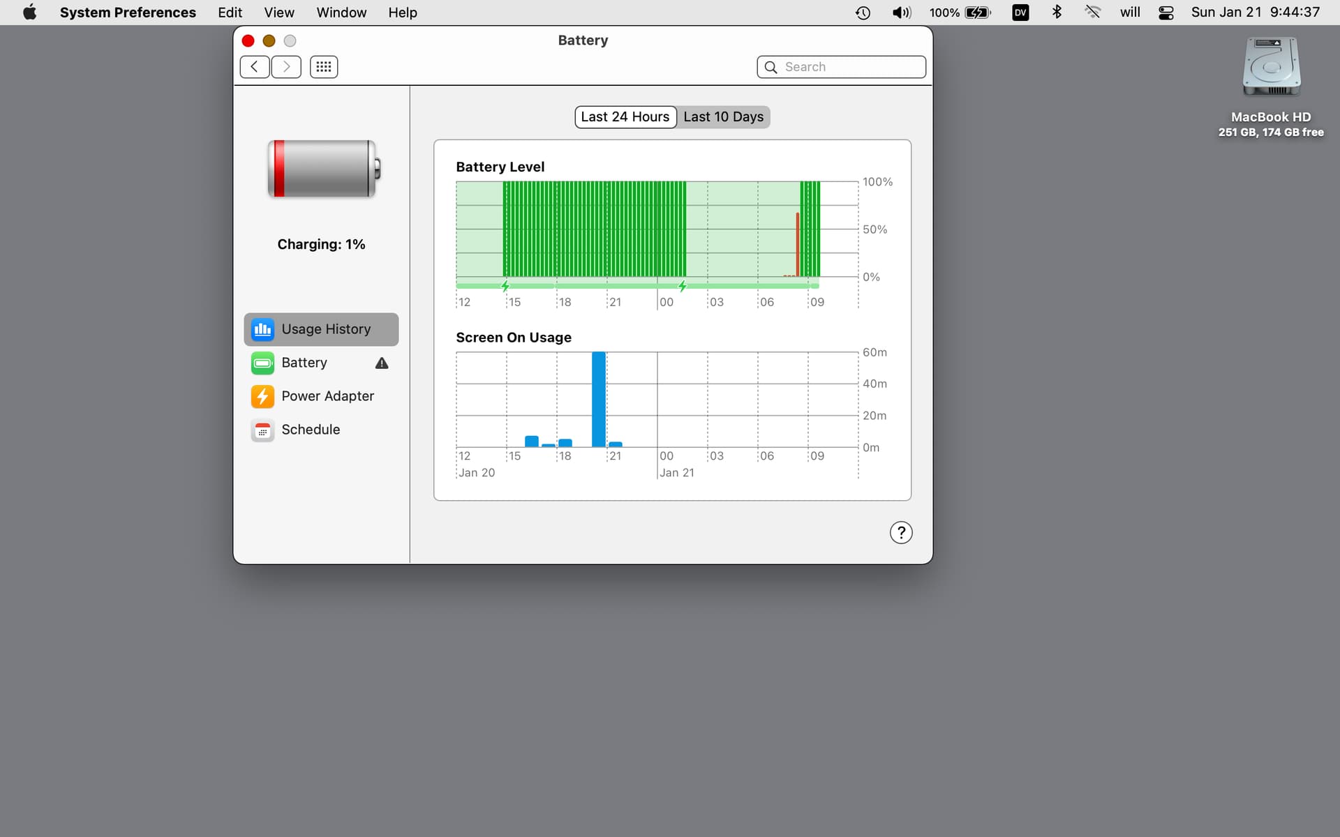

(Another peculiarity is that the first of the two above screenshots has the battery at 100% in System Preferences > Battery but the menu bar icon seems to indicate a complete discharge, while the second, taken 2.25 hours later, shows the battery at 1% in System Preferences > Battery and 100% in the menu bar.)
What should I try next? What more detail would be significant? Is it time to retire the MacBook? Thanks.

I assume you mean the battery icon in the menu bar. Clicking or option-clicking has the same effect, and the message is Service Recommended. I first noticed that message years ago, but I use the MacBook almost exclusively with the power adapter. When I do use it on battery, it is almost always for five minutes or less, and that has been fine. Even now, once I get the MacBook aroused from slumber and charged to 100%, it can go five minutes and the battery charge indicator still shows 98% or 99%.
It doesn’t seem to be a battery problem; it seems to be a charging (or discharging) problem. It’s as if the MacBook forgets that it’s connected to the power adapter. Somewhat over half the time, after I open lid, it is disconnecting and reconnecting the power adapter that causes the computer to wake up. (I did swap both the power adapter and the charging cable before resetting the SMC. It made no difference.)

I agree, if it’s worth replacing the battery, But as I said, the problem does not seem to be with the battery. The battery goes dead (1%) while connected to power and not in use, but charges just fine while connected to power and in use. Does that seem like a new battery would fix the problem?

OP here, with a follow-up. In case it wasn’t clear from the start, the behavior (discharge of the battery while connected to a power adapter) began abruptly about a month ago. After another reset of the SMC, the MacBook behaved normally for a day, then again began discharging the battery overnight, even while connected to the power adapter. About three days later, with no conscious change on my part, the MacBook spontaneously stopped discharging the battery overnight and it has behaved (what I consider to be) normally since. I hope I haven’t jinxed it.
In summary, I don’t know why the problem started and I don’t know why the problem stopped.
