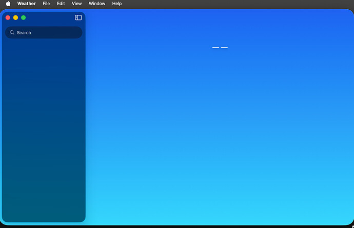

This morning (Dec 20), re-started the Mac and found it keeping time accurately down to the second. The Maps app now works fine. But Weather still looks like this:
Anyone know how to fix the Weather app?

Mac Weather app fixed. Simply had to search for a my location (city) in the app’s search field. Then in the app: File > Add Location to List.
Apparently the app had forgotten my location. Perhaps had it saved in a plist which somehow got zapped?
