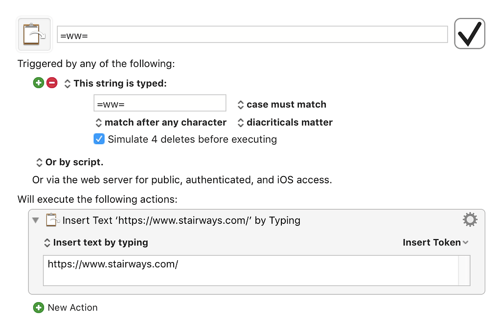

You can set macros in Keyboard Maestro to execute when you type a string. I have several that type common phrases for me for situations where Apple’s normal text expanding doesn’t work (like in Mail, website forms, etc).

Keyboard Maestro has Typed String triggers, and then can insert text from that, so for example I use =em=
to expand to my email address.
You can see a simple example at:
